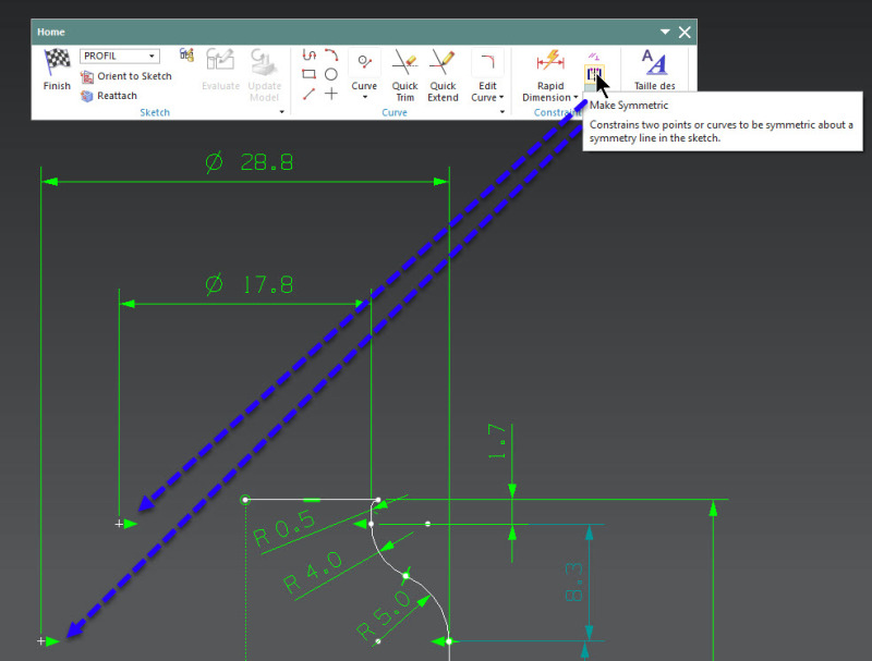

Hi Loki3000,
It's not easy like SolidWorks but I often use make symetric then cylindrical dimension to do the job

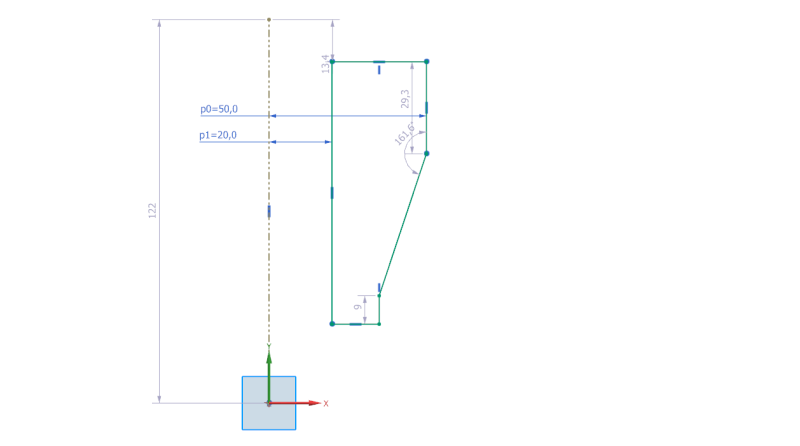

I must be totally missing something. You can dimension any line pretty much any way you want in NX...
I revolve sketches about their reference axis all the time and it is a breeze. Maybe we are not on the same page.

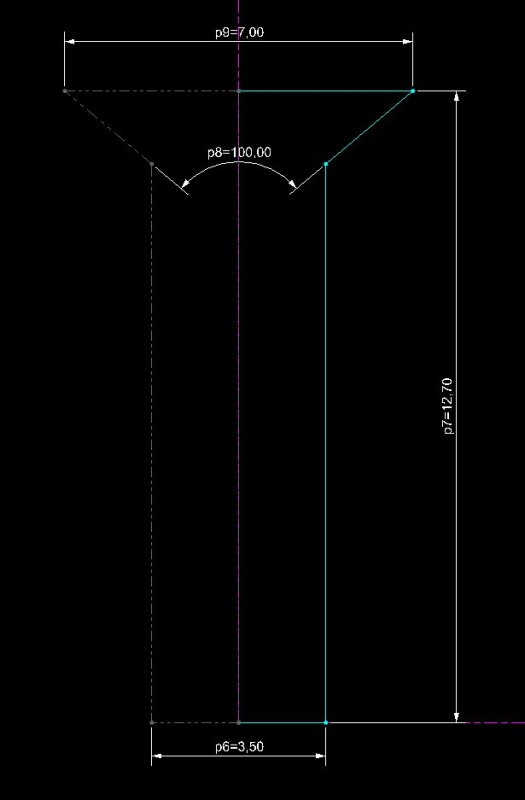

here a flat screw revolve example (I see the shape of the screw)
Right, I don't see why you cannot dimension to the centerline instead above. screw shaft would be 1.25 and top corner of head would be 3.5. I'm confused why people think it's not possible or easy to do this.
Felix K. Holloway - Designer - NX 9 & 11 Native

I prefer my solution because I display all dim as PMI, then it's a gain of time in drafting.
Regards
Didier Psaltopoulos
