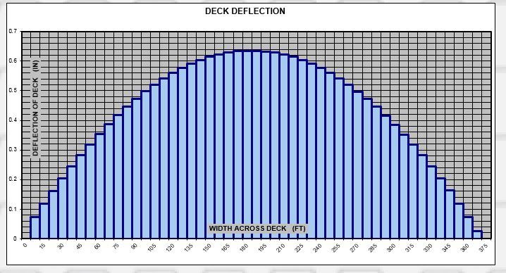

Hello,
I am working on a new wood framed building. There are several dormers where the double top plate will have a discontinuity. Please see the attached sketch.
Based on diaphragm design, the chord force is around 2.5 kips. My question is the following, how do I connect the plates at these locations. My first idea was to install a steel frame at these openings, weld a strap to the end of each steel post and nail the other side of the strap to the next continous double plate.
Any other ideas would be greatly appreciate it.

Your sketch assumes flexural deflection. Diaphragms have significant shear deflections so that 3x rotation, and your sketch, isn't all that meaningful or correct...Even with your not-correct flexurally deformed diaphragm,
While I agree that wood diaphragms undergo significant shear deformation, the assertion that my flexural analysis is meaningless or incorrect is seriously flawed.
1) Just because shear deformations exist, that's no reason not to bother looking at flexural stresses strains.
2) If flexural stresses and strains are not important or relevant, then why bother with chords? We certainly don't bother with them to deal with shear deformation.
3) Shear deformations are additive to flexural deformations. As such, you'll see the 3X strain shown in my sketch and then some more drift as a result of shear deformation.

The true diaphragm drift is a combination of shear deformation (roughly shown here):
AND Flexural deformation - that you illustrated in your sketch above.
I commented that your sketch was not really correct - and it is not - it ONLY shows the flexural deformation of the diaphragm and ignores the significant share of shear deformation.
You provided that flexural deformation sketch to support the notion that the depth of the diaphragm affects the resulting arc length at the eave, which it does - but not 100% as you implied.
I agreed that there was additional strain at the outer eave but again - not due to 100% of the flexural deformation (the 3 times value you showed) but the TRUE eave strain would be somewhere below that amount.
The influences of both are present. For most diaphragm sizes in wood construction, the shear deformation tends to be more influential in the total deformation than flexural but then I even conceded that if the 3 times amount you incorrectly showed was present, you'd still have small amounts of strain in the chord, which you agreed.
