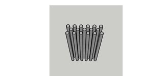

I've been looking for some tubing, (stainless is spendy) best I found so far is this.
1" OD 304/304L Stainless Steel Tubing, 16 Gauge (.065), Welded, A269, Mill ID, Bright Annealed​
would annealed effect the heat transfer? I can get enough for 6 18'' tubes for $50 what do you think?

Don't know. The heat will discolour the tubes pretty fast, but shouldn't affect the heat transfer.
Just note that the tubes will be very hot at the bottom end especially.
Let us know how it goes.
Adding fins on the inside and outside will substantially improve the heat transfer efficiency.
Note, however, 6 1-in tubes has only 37.5% the cross-sectional area than a single 4-in tube; you'd need 16 tubes to get the same cross-sectional area to get the same air flow, but even then, the flow friction coefficient be at least 4x worse.

''fins on the inside and outside'' ? like this? 37.5% is significant isn't it?

That would work if you're planning on blowing air sideways through it.
If you're relying on natural convection then the fins need to be vertical.

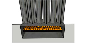

Something like this? What about more tubes smaller diameter? This would take a lot of brazing.

It's about increasing the surface area so both are good.
You prob only need two fins per tube and you can stitch weld/ braze.
Or use square or rectangular tubes? Would make it easier.
You do need to think about the gas flow of the hot gases so a few larger tubes is better for that.

Thanks, makes sense. Will depend on cost and what I can find.

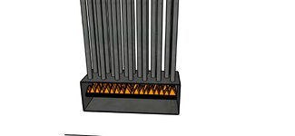

So I took the burner out of the old water heater, it still works fine. The calanoid opens the gas when 3 volts are applied. The flame sensor works but I had to order a signal amp module to get it to 3 volts. I have access to some 3/4'' stainless steel tubing, enough to build it as in the sketch. My question is would it be possible to press fit the tubes into 1/4'' aluminum as apposed to brazing into thin stainless? Would the 2 metals expand differently and open up? Also if you think this would be good spacing for the tubes?
Maybe, but you don't want to much gap for the flue gas to leak out.
Spacing looks ok but think that burner is just far too powerful. You probably only want 2 or 3 out of those 6 burners.
