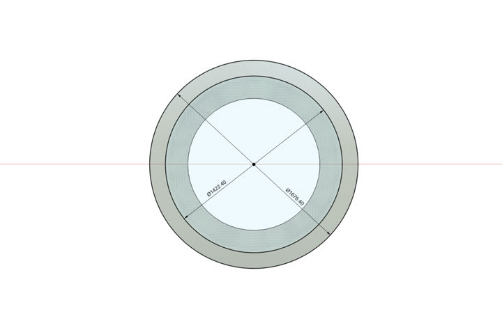

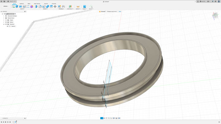

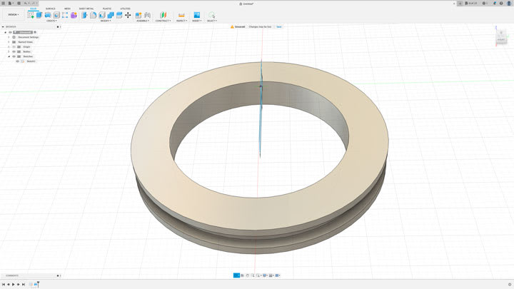

I am not sure if I understand the photo. So each titanium end head connects to a titanium transistion ring that then connect to the composite vessle. So at the connection point of the head to the ring is a 3" wide flange and at the connection to the composite side a 5" wide flange? And if so what are the OD and ID of the flanges? Can you provide a dimensional sketch?

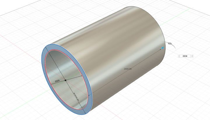

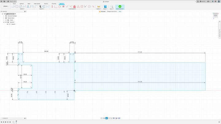

Here are the drawings, The flange dimensions are a total guess, The carbon cylinder is taken from wikipedia.
Joe
I still can't make out the dimensions of the flange as they are too small to be visible and the end cap is not even shown, or at least I can't tell as nothing is labeled. Anyway it is very simple to calculate the compressive force and pressure acting on any section of the vessel.
For the longitudinal sress in the wall, cut a vertical slice at the point desired. Multiply the hydrostatic pressure of 5800 psi times the total crosssectional area of the slice even the area not filled with any material (this is called the projected area). Then divide by the actual net material area of the slice.
For instance for a cut through the carbon fiber vessel the pressure in the fiber wall (which is actuall the compressive stress) =
Total Force divided by Net Material Area of crossection
Total Force = P x total area of slice = 5800 (Pi/4) (70)2 = 22,321,015.8 pounds
Divided by the net material area of the slice =
Pressure/Compressive Stress in Carbon Fiber wall = F/A = (22,321,015.8) divided by (Pi/4) (702 - 602) = 17,170 psi compressive stress in carbon fiber wall.
Note that if the bearing suface of the titanium flange on the carbon fiber wall is not the full thickness of the carbon fiber wall then the local stress at the contact point will be a little higher based on the actual bearing surface area of the flange on the carbon fiber vessel wall. However in short distance the higher local bearing surface stress should spread out to equal the stress calculated above on the crossection material of the carbon fiber wall. A finite element analysis can be used to determine how the higher bearing pressure spreads out/flows. An approximation would be that the actual maximum pressure stress at the juction of the flange to the carbon fiber would be the total force calculated above divided by the contact area of the titanium flange to the carbon fiber wall. The local bearing stress spreads out pretty quickly to the entire carbon wall section due to the transfer of bearing stress to the adjacent material by shear.
Also remeber that there are circumferential stresses and radial stresses present. In the carbon fiber vessel the circumferential stress is the total force divided by the net material area in the horizontal plane =
Pressure x total horizontal projected area of slice divided by the net material area, in this case the slice will be cut down the horizontal centerline of the vessel
Total Force on Project Area = P x D x L Where D is outside diameter and L is length of carbon fiber vessel
= 5800(70)(2400/25.4) = 38,362,205 pounds
Circumferential Pressure/Stress in wall = F/A where A = 2tL where t is wall thickness of carbon fiber
= 38,362,205 divided by 2(5)(2400/25.4) = 40,600 psi
Also there is a radial stress due the vessel being a thick wall rather than thin wall vessel, therefore there is three dimension normal stress components in the wall of the carbon fiber (and possible some shear?). However I am not sure if the radial would be same as calculated as those equations found for thick wall metal pressure vessels because of the different material properties of the carbon composite. I am not an expert in detailed 3 dimensional stress analysis.
