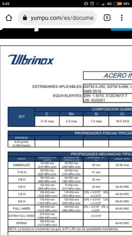

AISI 301 is stainless and I read that it would also work. Certain? This would be better because it is stainless. And as I said before, I think we should ask him to hold on to serve as a spring.
301 stainless is not heat treatable and can only be work hardened to 41 HRC which is less than 1075. If you need more corrosion resistance than 1075, 420 stainless steel may be a good option.
But I see 301 is used too in the manufacture of springs with a hardness of 40 to 50 HRC
Hardness 4/4 or 5/4 that will be equivalent to those in that table.
You can buy a lot of different SS alloy sheet to ASTM A666 and have it cold rolled to 3/4 or full hard for descent spring properties.
You will still need to waterjet or laser cut the holes.
Just see which SS you can get that hard.
It might be 301, or 304, or even a 201.
They will all have similar corrosion resistance.
The 200 alloys should cost less.

I definitely think that the 301 4/4 or also called full hard will be valid.
I see that 304 can also be hardened and that both obtain the same hardness but for laser cutting 304 is better and resists oxidation more.
