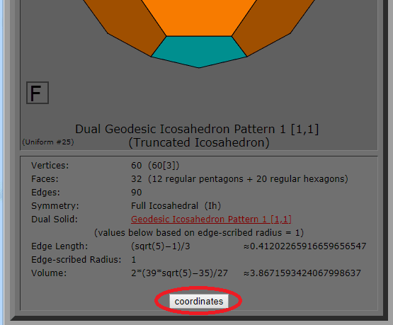

Rugge, how did you format the text file?
regards,
LWolf
thx Rugge, one more Q: my preview shows nice flat surfaces, however once pressing ok, my meshed surface gets rounded off... there arn't that many options to fiddle with sooo... whatamidoingwrong?
regards,
LWolf
found it! tools options-DSE, Display Modes, Mesh "Flat"
regards,
LWolf

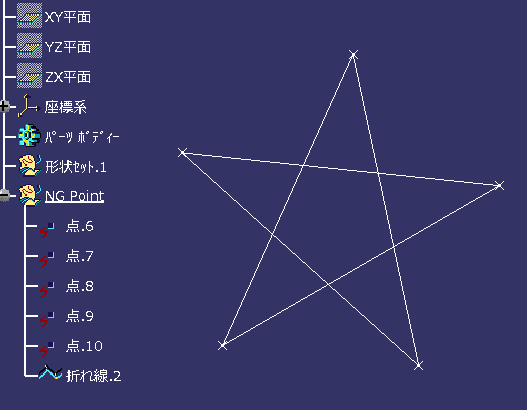

Because it was a very interesting theme, I creating a macro.
1. Please put "Visual_Polyhedra_Import.bas" and "SurfaceFactory.cls" in the same project.
The entry point is "CATMain ()" of "Visual_Polyhedra_Import.bas".
2.For each data of WEB site "Visual Polyhedra"
Please save coordinates as a text file and load it with macro.
3.After starting the macro, please select coordinate text data.
There are surfaces that fail to be created.
The reason is that the boundary of the surface is self-intersecting,
so it is impossible to create a fill surface.
In order to shorten processing time, creation of instances is minimized.

Kantoku, could you pls. attach an example of a correctly formatted txt file?...
regards,
LWolf
thankyou kantoku
wow I have to try
Hi.LWolf
1. Click "coordinates" to open the link.
2. Right click and save as a name.
thank you. I still get the message "could not create a surface"... any idea why?
regards,
LWolf
sorry, still "could not create a surface" message...
regards,
LWolf
