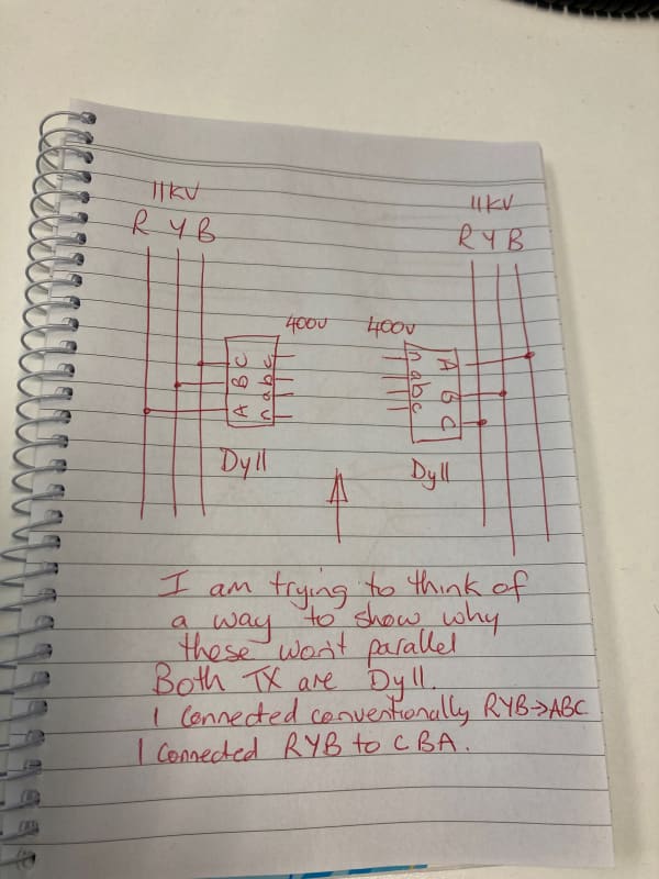

Hi
We have a few situations where 11kV/400v TX's are put up poles that have their ABC terminals connected to BYR phases in that order so won't parallel with the next transformer down the line that has been put up the conventional way of connecting RYB to ABC. (The Tx's have been fitted up poles n opposite sides of poles) Does anyone have a quick method of drawing this out either with vector diagrams or simple analogies to explain why it won't parallel. Thanks

Thanks Beyond86 - both Transformers are Dy11. I am waiting for the exact voltages between the Transformer secondaries but we do know they won't parallel. We have had this in other parts of the network and I just can't think of a way to prove it graphically why it won't parallel.

I have added a photo of a drawing showing what I was trying to describe, but just can't think of how to draw it out vectorially or some other way.

Your displacement is off. There is a 60 degree difference. Roll R & B on one XF.

Forget about a to a, b to b, and c to c...
Think about rotation and displacement.
Let’s say RYB is ABC rotation. That is, B follows A, and C follows B.
You connect it to the XF with R to H1, (which I’m assuming you are calling A on the XF)
Y to H2, and B to H3. On your nameplate it will look exactly as shown with the secondary lagging the primary by 30 degrees.(or high side leading low side by 30 degrees)
Now, take the exact same transformer as you have done and connect it as you have. That is, R to H3, Y to H2, and B to H1. The nameplate drawing is now a “mirror” image. You are now “rotating” through the transformer backwards, which when drawn out shows you now have the secondary leading the primary by 30 degrees. (Or high side lagging the low side by 30 degrees) IA+ic=ia. IA=ia-ic
When you try to parallel these two transformers on the secondary side, (swap the a & c wires on one XF to try to match rotation), you will find there is a 60 degree difference in the voltages.
That’s where the 120 and 60 degree disagreement is coming from in these posts.
You can fix rotation on the secondary side by swapping wires to parallel. You have to swap wires on the primary side to fix displacement issues.
