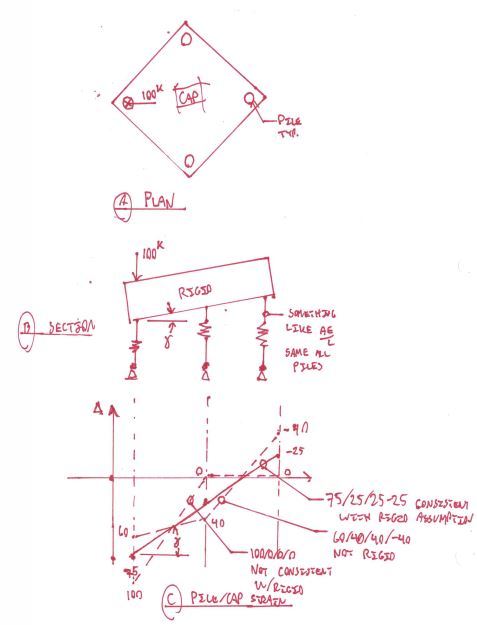

Strain compatibility. Modelled with a rigid cap and all piles modelled as axial springs having equal, bi-directional stiffness, I do not believe that your solution would satisfy strain compatibility. When the loaded corner depresses, the cap rotates and the other corners displace as well. As such, they draw load.
That said, if you provided 100% capacity at the the one, loaded corner, I doubt that you'd be in any real world trouble. Cap flexibility and reduced pile tension stiffness would shift things closer to that distribution anyhow.
OK, so Hokie93's numbers are in static equilibrium. But you can change those numbers, just keeping the tabletop balanced about the diagonal. So there is apparently not a unique solution using that method.

Consider the case where all 100 kip is applied over one pile as you've suggested. Now draw a diagonal section through the cap from the loaded corner to the opposite corner. In that section, the cap (assumed rigid) will have a slope to it, right? If so, then at least two of the piles must have non-zero vertical displacements and therefore non-zero reactions. In my opinion, that makes the 100/0/0/0 solution inadmissible.

As I demonstrated above, the rigid support assumption is not an admissible solution from a strain compatibility perspective so long as the very common rigid cap assumption is at play:
The last part about my solution being inadmissible is astounding to me. But then I don't accept that the cap would have a slope. Even if it did, how much slope? Why would not the degree of the slope affect the reactions?
KootK,
Sorry, I missed one thing you asked for. 7 Dec 2109 you asked for another solution similar to Hokie93's, as I said it was not unique.
Try 70/30/30/-30. Or 80/20/20/-20. Or 100/0/0/0.

Well, before I go all David Copperfield on this, let's keep in mind that it's only inadmissible in a strain compatibility sense given a particular set of assumptions. I've no doubt that your solution is perfectly acceptable as a real world solution. In fact, if I was designing such a system, I would probably go Hokie66 for the pile under the load and Hokie93 for the other piles and the cap. Maybe a little more Hokie66 for direct bearing checks over the loaded pile.
Fortunately, for the P/A + Mc/I analysis, you don't actually need to know the slope. You only need to generate a solution where the pile strains would be consistent with a constant slope of some magnitude across the underside of the cap. The slope definitely would affect the reactions. That's part of the method. All this is similar to how one would calculate stress in a beam without actually knowing the curvature explicitly.

Thanks for this. In the sketch below I plotted 60/40/40/-40 instead so as to exacerbate the difference between that and the other solutions graphically. My argument is that, because the piles strains do not lie on a straight line, the solution is not consistent with strain compatibility (assuming rigid cap and equally stiff piles). Kinks in the graph suggest non-rigidity in the cap. Similar logic would apply to the two bonus solutions that you supplied.
A neat piece of work, but all it tells me is that the method proposed seeks a triangular stress distribution, similar to an eccentrically loaded footing on soil. I don't find that logic applicable to piles, and neither would I use it for soil with a load at the edge.

Ok, I was looking at it from a purely analysis perspective.
I can see what you are doing but it relies on
- the pile cap being rigid.
- all piles being the same length and founded in exactly the same material. Reasonable assumptions at design time but they would have to be confirmed on site depending on the slope of any geological features etc.
- And the tension response of the piles is exactly the same as the compression response for the piles, which I would doubt even at design time as compression is probably dominated by end bearing while tension would be purely skin friction.

Yep, made most of those same points myself along the way:

Well yeah, we're not splitting atoms here. That said, the rigid cap pile strain gradient concept provides the answers to several of your inquiries here:
- why the Mc/I crowd has been challenging your load distribution.
- why I've been harping about strain compatibility inadmissibility.
- the effect of cap slope on pile reactions.
- the existence of a unique Mc/I solution.
