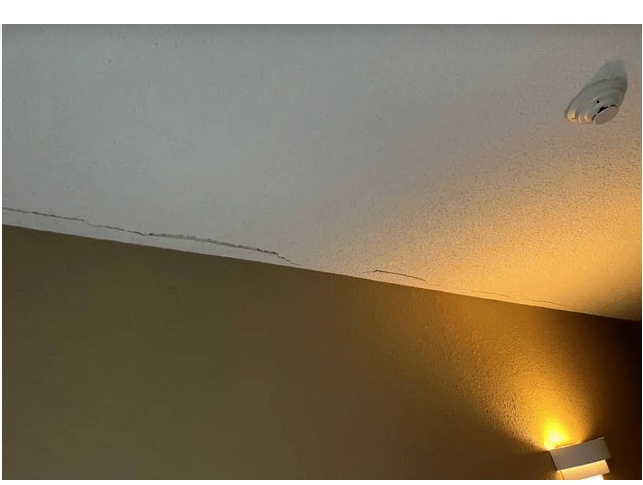

From the pattern of diagonal cracks in the stucco, it appears things were already moving.
EDIT: The diagonal crack pattern may be an artifact from a video screen grab or shadow from the deck railing.

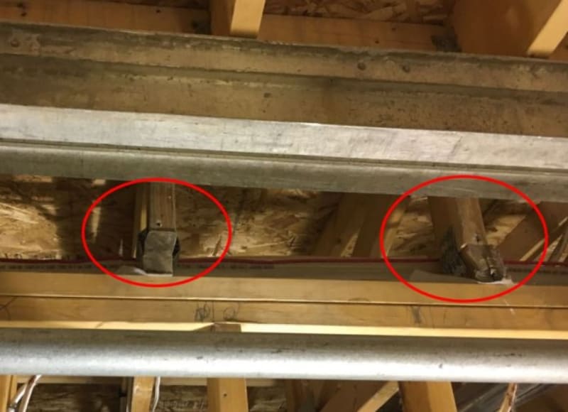

The below article contains information and pictures from the engineering report (but does not include the whole report).
Global News said:
The engineers identified three main issues in the unoccupied, fire-damaged areas that might also be present in the occupied areas:
1. Missing blocking at the ends of the trusses that has led to observed crushing failure of many of the second floor truss bottom chords at the corridor walls.
2. Main and second floor corridor interior load-bearing walls constructed using 2 x 4 studs instead of 2 x 6 studs specified on the original structural drawings.
3. Partially buried, main floor exterior walls that are bowing inward due to the earth pressure against them.
During inspections in late August, the engineers noticed extensive drywall cracking in some areas.
“This ceiling cracking is most prominent and extensive on the first floor (i.e., at the underside of the second floor framing). There is similar, if slightly less extensive cracking, in the second floor corridors, and it is reduced further yet, but still visible in the third floor corridor. (The ceiling framing in the fourth floor corridor is comprised of the roof trusses, which is different from the floors below, and there was no cracking observed.),” an Aug. 30 engineering report stated.

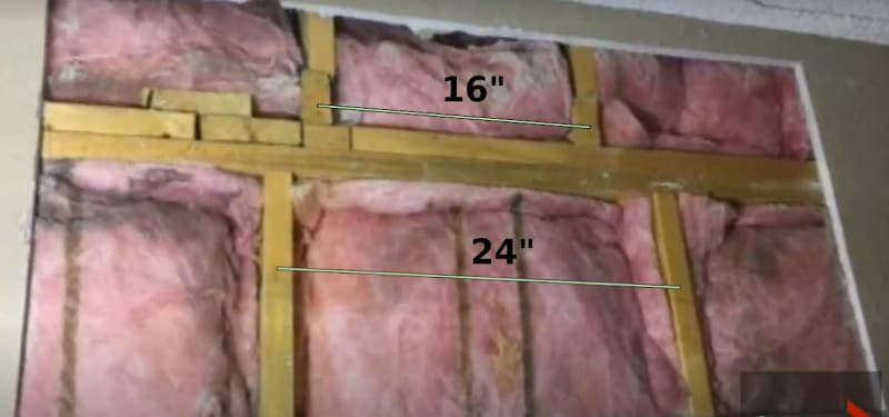

The pictures are quite a treat. I like how the "joists" are not placed above the studs, for example. THAT is something I just don't see that often. Also the curious offset of what appear to be light-duty straps connecting the framing members.
spsalso
By my eye, stud spacing has been economized as well. Seeing the crushed truss makes me wonder why the designer thought this was a good opportunity to spread out the studs.
I suspect the designer didn't draw it like that.
Its like our conversation about internationally builders actually have drawings on site never mind read them. My experience onsite on my DIY build is that they are extremely upset when forced to comply with an engineering detail. Then it never mentioned again when it works better then the way they wanted to do it.
And I suspect the designer also didn’t specify use of random small scrap wood pieces for the top plate.
Yet they kept the 24 inch spacing allowed for 2 x 6 studs.
Best of both approaches I guess. And claim Green Points for using fewer trees.

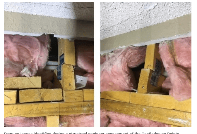

More pictures:

And more, showing the extensive deterioration and remedial measures. I suspect the residents will recover their belongings in time but not before its time.
