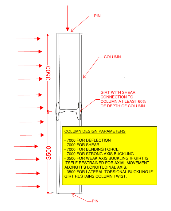

I am assuming the column is pinned at both ends and taking the column as a beam for approximate analysis. the length is 7m and I want to take the effective length (3.5m) to reduce buckling, do I use 3.5m length from the start of my calculation from finding reactions, sf, bm and so on.. or only use (3.5m) when finding buckling check?
in real life how is the length reduced to an effective length of 3.5m when it is actually built to 7m?
If the column is physically 7m, all of your reactions/shear diagrams/bending diagrams need to be based on a 7m length.

thanks for advice I have cone to deflection the only problem is the actual deflection exceeds the assumed deflection when using length=7000mm but when I reduced it to 3500mm the deflection check was ok. so is it okay to use 3500mm assuming effective length for deflection is that incorrect. if I change the steel section the new section will be so big for my structure. I have done the bending and shear resistance they are ok with when using 7m length.
no....the effective length does not equal the analysis length of the column. The effective length when adequate bracing has been designed and installed impacts the load carrying capacity of the column for failure modes such as buckling.
Your shears, moments, slopes, and deflections will all still be based on the full 7000 mm length of the column.
Alternatively if you place additional framing @ 3500 mm and that framing is capable of resisting the reactionary forces and has adequate stiffness you could then look at the column as a continuous beam-column with two spans of 3500 mm.

By pinning the column at mid height.
BA
if I pinned the column at mid height can I just analyse one part(3.5m) as simply supported? instead of analysing full 7m column, there will be a beam running the mid column and will add bracing. will that be ok? Or if i cantdo that will i have a 7m span with 3 reactions spaced at 3.5m?
@OP: based on what you've written here so far, I suspect that you have some serious and fundamental misunderstandings to sort out. I'd recommend stepping away from this thread and asking this question of an engineer who's face you can see. For what it's worth, I am one who makes this kind of recommendation very sparingly.
If the column is continuous with the midpoint pinned, any rotation at the pin will result in an equal and opposite moment above and below the pin and zero moments at both ends of the column. If the column is broken at the midpoint, i.e. completely hinged, one 3.5m section of column behaves as simply supported, and the bracing system provides any reactions required for equilibrium.

As per the drawing the column in one direction has alength 7 m and other direction 3.5 m by assuming it is pinned in bot end. If there is no beam in the middle it shall be 7 m in both direction. Considering if the mid beam is weak and can not prevent the lateral buckling so you must neglect it in your calculation.
Correct me guys if I am wrong but Effective Length does not play a part in the calculation of forces, the actual structural analysis (for loads) or any movement or distortion magnitudes. Effective length is only used when you have determined the forces in the member and are now doing your material check (steel, wood etc). Is the value of "K" actually in the stiffness matrix?

If the effective length of a column is reduced by pinning the midpoint, then under an arbitrary set of applied loads, the shear, moment, slope and deflection will all change.
BA
I know adding pin will will change the forces in the column, but the K-value used to calculate the "effective length" is not part of the stiffness matrix values is it? In other words, adding a lateral flange brace to reduce lateral buckling does not change forces, it changes allowables. The end conditions (pinned vs fixed) are already reflected in the degrees of freedom.
Maybe I am confused on what Civil is doing. Are they adding a support or a lateral brace? And I do not understand "taking the column as a beam". I am envisioning the situation being as depicted in KootK's drawing.
a note of caution...if you have bending in the column, ensure that you dont half the lateral torsional bucking lenght if the brace and connection cannot transmit the small moment at that connection. a simple shear connection as shown in kootk sketch may or may not be suitable for this purpose.
Certainly, I agree with this as a general statement. And it's a very important point for OP to recognize if she doesn't already.
