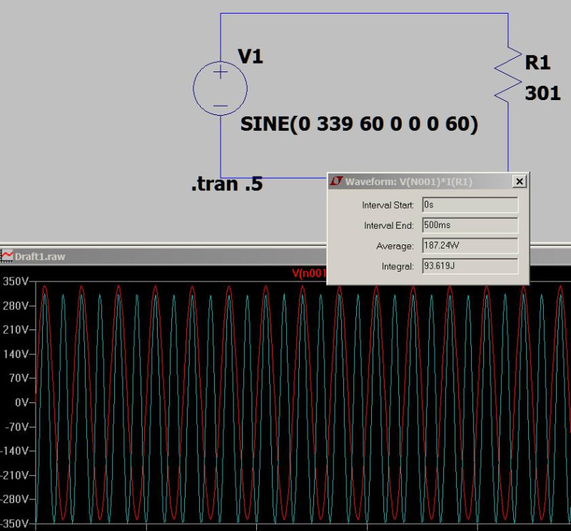

To check for myself I decided to simulate it on everyone's favorite simulator LT SPICE. I used a 301Ω resistor (a standard size).
I used a 60Hz sine wave and since this all shows instantaneous you'll note the 338V peaks from 240Vac.
Here's no diode: The Average power shown in the "waveform box" is 187W without a diode.
Here's with a diode the average shows 91W:
