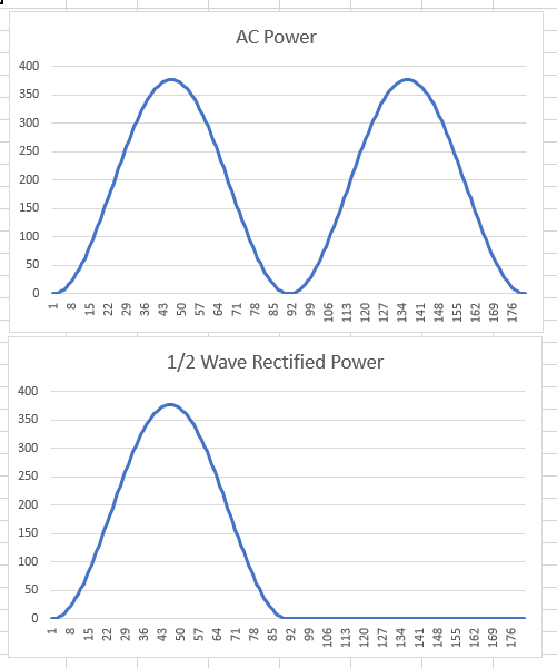

I have a 7.5 kW motor with 110V, 40W anti condensation heater. But i have only 240 V supply for the heater, can I put a resistor in series with the heater to reduce the voltage please.
No, once you have RMS voltage you simply divide by the resistance to get the RMS current.
A period of the voltage waveform is the same amount of time for both the AC and 1/2 wave rectified voltage. So, it would be wrong to only use part of the period when calculating the RMS voltage or current for the 1/2 wave version.
Am I following this correctly.
The heater is rated 110 Volts and the supply is 240 Volts. The heater is rated at 40 Watts.
At 240 Volts the heater will develop (240/110)^2 = 4.76 times 40 Watts or 190 Watts.
If the diode cuts that in half it will produce 95 Watts and will burn out.
If Lionel is correct and the RMS with the diode is 169.7 Volts the heater will produce (169.7/110)^2 x 40 Watts = 95 Watts and the heater will burn out.

rhatcher - A half wave rectified voltage is a periodic waveform, not DC. The output of the diode is not a constant DC voltage, it is a periodic voltage which equals the AC input 1/2 of the time and 0V the other half.
Pavg = Vrms^2/R - the correct calculation to use for any periodic voltage waveform.
Pavg = Vdc/R - this is only valid when the voltage is a constant unchanging DC.

Well, doubling the voltage increases the power four times.
Using a diode cuts the wattage in half.
To cut the wattage in half, we must reduce the voltage by root 2.
Gosh. No wonder that the equations for wattage and for voltage are not the same.
And the point is that the heater will probably fail no matter if we cut the power in half or if we reduce the voltage by a factor of root 2.

The visual way to show the power change with the diode is to draw the instantaneous power curves. The diode will remove half of the instantaneous AC power curve, hence it must reduce the heater power by half. Keith kind of showed the curves, but not very clearly.

Your graph shows in exquisite detail what I was trying to get at; nice work.

The “DC viewpoint” is apparently that the power dissipated in a resistor fed from a sinusoidal source is reduced to 25% or less by inserting a half wave rectifier between the sinusoidal source and the resistor. This is based on an assumption that the “dc” or "average" value of the voltage waveform (50% or less) should be used to calculate power (when we square 50% or less voltage we get 25% or less power).
Everyone else says that inserting a half wave rectifier between a sinusoidal source and resistor decreases the power to 50% of what it would be if the resistor was fed directly from the sinusoidal source. This is based on either simple examination of the instantaneous power curve (see Lionel’s graphs a few posts above this) or rms concepts (which tell us to use the rms value of voltages for power calculations, NOT average/dc values). The people in the 50% "camp" (*) are:

The answer becomes much simpler once you accept this.
As for RMS - there is no such thing as DC RMS or AC RMS. It's just RMS. You can calculate the RMS voltage for ANY periodic waveform.
When all else fails, don't go by your gut, don't go by some canned formula, don't go by a meter reading when you're not sure if the meter is correct. Go right back to basics. In this case, every engineer was first taught to calculate the RMS voltage of a waveform to determine the average power it will produce in a resistor. So, do that with this waveform.
