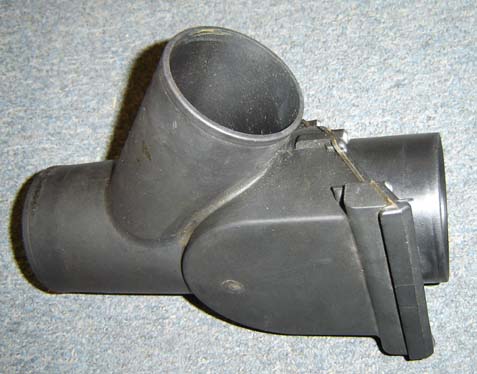

Fabrico, the bypass your describing does work, I have one from a Penta/Volvo somethingorother we used during testing of the Hydracharger. I dug it out this morning and took a picture of it, I think being a Penta it is from a marine application, maybe someone else would know if they saw it. It has a 3.25" inlet checked by a flopper door, a 3.25" outlet, and a 3" y'd inlet for the compressed feed. Here is the picture.

I hope you don't mind posting your picture jimwolf, but that's just the kind of low tech, reliable components I've been talking about. The unit I worked with was a little more streamlined and had a position sensor for the door. The sensor told the controller that the turbocharger was taking over and to unplug the electric. Failsafe really.

Yes, all the electric boost systems I have seen so far are just a complete joke, like this one for instance:
