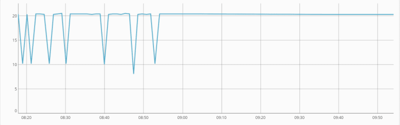

Firstly, I have no idea if I am posting this question in the correct forum, hopefully it's correct. Secondly, I am not an engineer in anyway. I have an issue with EMI from a 3 phase 480v VFD affecting a shielded temperature probe and was hoping somebody on the forum might be able to offer some advice on how to solve my issue.
If I leave the temp probe hanging in the air then the EMI has no affect on the temperature reading. However, as soon as I put the temp probe into the water I start getting temperature spikes. If I only needed to measure the air temp things would be fine, sadly this is not the case.
Does anybody have any ideas on how I might fix this issue? I have ordered some ferrite rings to install on the output side of the VFD. Also, I tried placing a small metal rod in the sump and grounding it with a wire but that hasn't helped.

Graph showing temp probe in and out of the water.

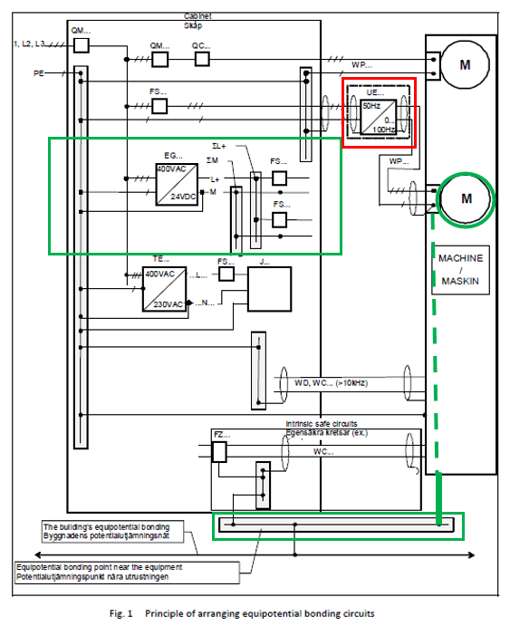

It's also important that the motor and pump is properly potentially grounded.
This is not the same as protective earth PE.
Since most of the equipment is plastic this might not be so and that the motor cables are shield and connected to the bonding circuits.
The red square is the inverter.

> For some extra info, this is how things look when the VFD is off but the probe is still in the water
The plot shows spikes and then constant temperature. Are you saying:
[ul]
[li]1 - the vfd was off the whole time[/li]
[li]or[/li]​
[li]2 - the the vfd was turned off during the middle of the plot (spikes before turnoff, no spikes after turnoff)[/li]
[/ul].
(2B)+(2B)' ?
Electricpete - The VFD was only turned off after the temp reading returned to normal

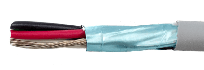

3DDave - It's a RJ11 connection. The wire used is alpha wire, type 78104
veryconfused said:
For some extra info, this is how things look when the VFD is off but the probe is still in the water[/quote[
or​
thanks. It's an important answer and I want to make sure we understand exactly what you're saying. Is it scenario 1 or scenario 2?
(2B)+(2B)' ?
I turned the VFD off around 09:00. So spikes before turnoff, no spikes after.
ok, that clears it up nicely. Sorry for being dense. That definitely steers us towards vfd noise rather than towards moisture.

:) Early in the thread he wrote that the spikes disappeared when he took the probe out of the water.
If the interference had come from the probe cable being to close to the power cable to the motor and especially if it wasn't screened the spikes would still be there even if the probe is in the air.
I think we can exclude that one.
And the Avtech "telefon" cable does not look exactly as his, the one on his probe looks more round.
He wrote that it was a Alfa wire 78104 it looks like this.
ok, good that looks a lot better than telephone wire.
