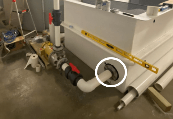

Firstly, I have no idea if I am posting this question in the correct forum, hopefully it's correct. Secondly, I am not an engineer in anyway. I have an issue with EMI from a 3 phase 480v VFD affecting a shielded temperature probe and was hoping somebody on the forum might be able to offer some advice on how to solve my issue.

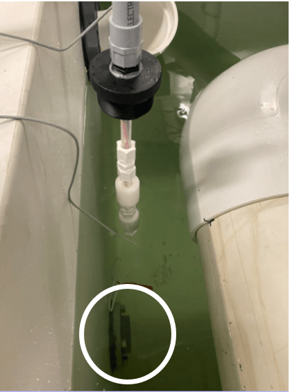

If I leave the temp probe hanging in the air then the EMI has no affect on the temperature reading. However, as soon as I put the temp probe into the water I start getting temperature spikes. If I only needed to measure the air temp things would be fine, sadly this is not the case.
Does anybody have any ideas on how I might fix this issue? I have ordered some ferrite rings to install on the output side of the VFD. Also, I tried placing a small metal rod in the sump and grounding it with a wire but that hasn't helped.
Any help/advice would be greatly appreciated.

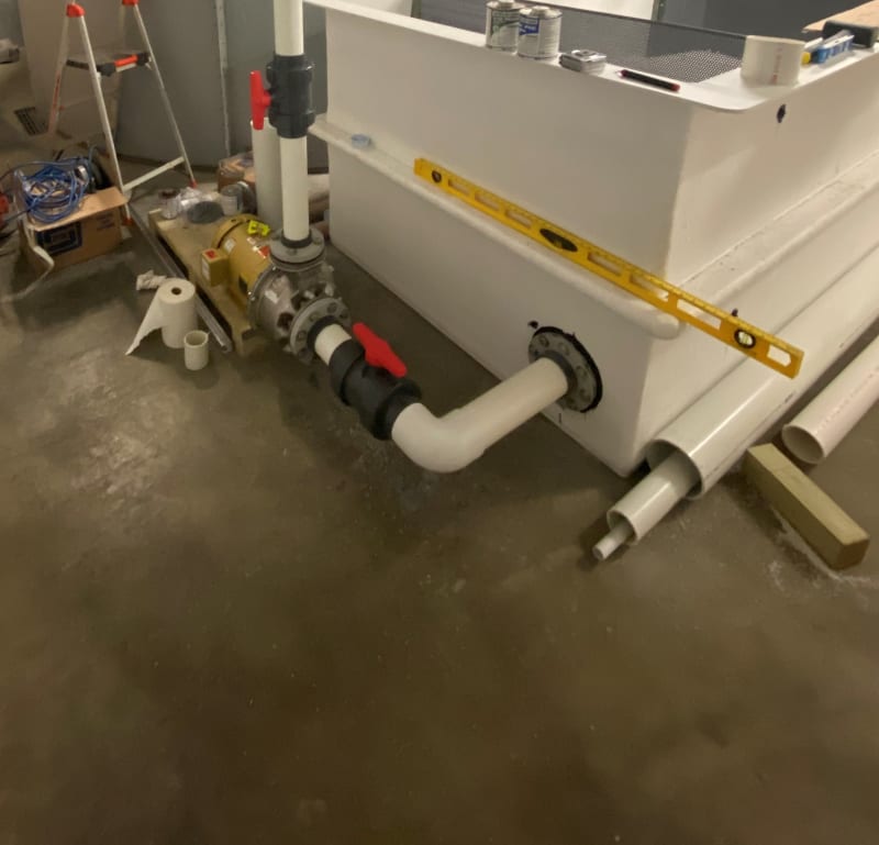

You can see the red temp probe in this image
Position of VFD relative to temp probe
Graph showing temp probe in and out of the water.
Electricpete - No submersible pump. This is the location of the pump that is connected to the VFD. I will try a grounded can or something around the probe to see if that helps.
I did drop in some stainless steel rods into the sump and grounded those, however, that didn't help. I wonder if moving the probe closer to the grounded rods might help. I will try that.
of the main pump that runs of the VFD.

The pipe passage you can see below the temp probe is for another pump, not pictured. That pump is not on a VFD and has not been running at all

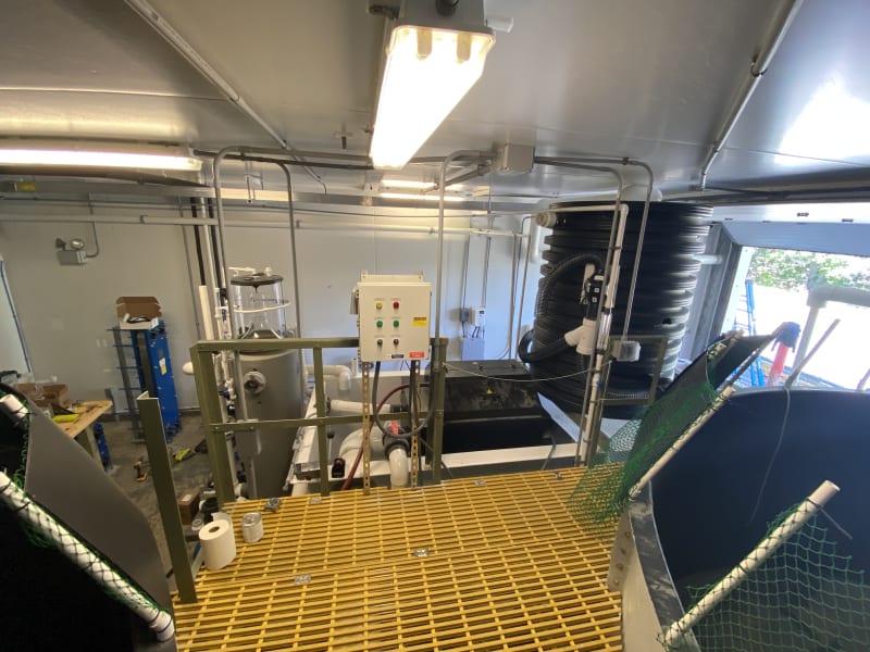

The black thing, is a drum filter.
Okey is the probe that you are having problems with near this drum filter or does the tank with the VFD drive not have one of those?

Redsnake - yes, the probe is near the drum filter. I’m not quite sure what you mean with the second part of your question.

I was wondering if the the motor with VFD drive is supplying the same tank that has the drum filter?
And that is the tank where the probe problem is.
And this drum filter is powered with a ordinary motor I suspect.

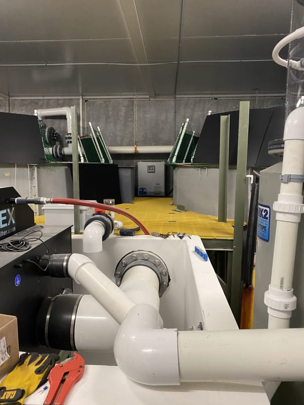

Redsnake - the water is pumped from the white tank you see in the photo into two tanks next to it. The water then flows out of these tanks into the drum filter that is sat on a fiberglass stand in the white tank. The drum filter has a small motor that turns the drum when needed.
Do you think putting the probe in some kind of faraday cage would help?
To give you an idea of how far this magnetic field reaches, if I put the probe in one of the other tanks I get the exact same issue. It’s weird.
I do have an AC voltage detector, so that’s something I can try.
This images shows to two other tanks.
