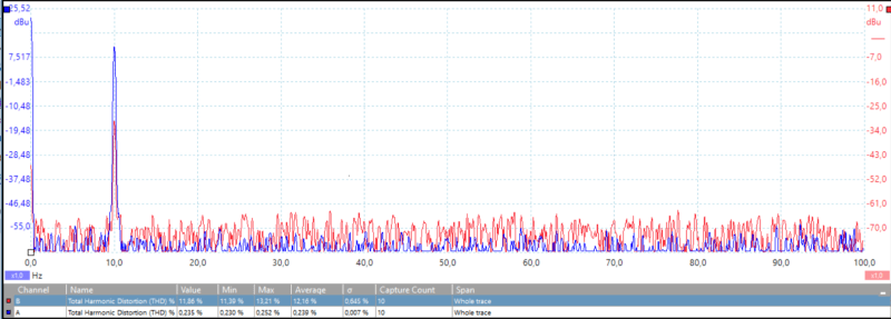

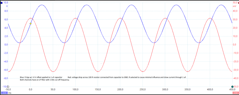

No. There's no second harmonic in capacitor current. I went down to 10 Hz without seeing any trace of 20 Hz. Or any other harmonics. Could do 1 Hz, but the time needed isn't worth it.
Still, there is a pronounced change in capacitance vs voltage in the three capacitors I have worked with. The funny thing is that capacitance goes down when voltage goes down. I expected the opposite. And the opposite is what most references show. THAT is a mystery. Pictures:
Blue is applied voltage. Red is current.
Current spectrum has a thick noise mat. But no pronounced harmonics.
From the point of view of the capacitor (in the 'ELI the ICE man' sense), I'd phrase that as follows:
Red is applied current. Blue is the (resultant) voltage.
Your original phrasing left me scratching my head for a minute! :-)
THAT long?
I applied a voltage from a generator and that resulted in a current. No need for head-scratching. But some head-banging, perhaps?

No milliseconds effect seen. So I think that the variation I saw when measuring on a minute scale may have been larger if I measured over longer time. The Al2O3 probably takes some time to change.
