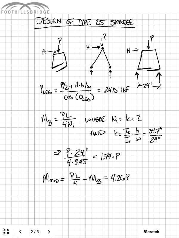

I've now copied about two weeks worth of project notes into the supernote. The writing experience is superb. To me, it feels just like pen and paper. But being able to move notes around the screen, erase a messy stroke, and add space between notes after the fact is fantastic.
I've been using individual note files for each project (each linked to quick access) and titles throughout the files as section headings. Supernote picks those all up and creates a table of contents. Super handy. I haven't integrated keywords or links yet.
I'm primarily using the "notes". However, I did experiment with creating a word document using the handwriting input, then converting that to text with OCR. It was remarkably accurate for my sloppy handwriting. Then using proofreading strokes to manipulate the word file is pretty slick. I don't see doing this regularly, but might come in handy for something like meeting minutes where I expect to send the notes out to others afterward. It doesn't pick up greek symbols or equations though.
I was easily able to slightly modify a standard note template to include a company logo header.
I was easily able to sync a handful of common reference materials to the supernote using the cloud sync tool. Can just as easily sync sketches and notes back to drop into a file on my computer. (Also could be done over USB). For anyone who wants to challenge KootK's reign of timely sketches here on ET, this might be your ticket.

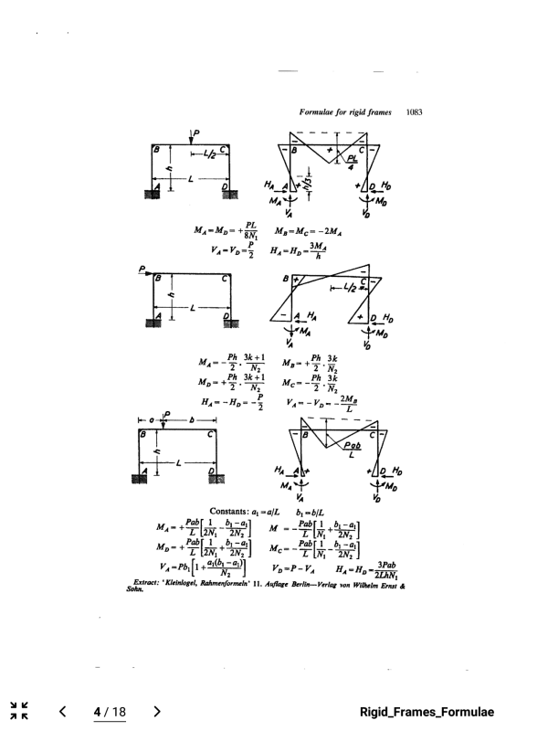

Lomarandil... what is your frame text that you posted a clip from?
Agreed Dik. I do most of my production calcs in Smath, and historically also have a "scratch calc" file for each project just to run small numbers like this example. But I'm finding that the Supernote can be a reasonable option for those scratch calcs, particularly if they really benefit from being attached to a sketch. (Yes, you can put sketches into Smath easily, but that does take a minute or two).
The frame analysis screenshot is from Kleinlogel.
Small update: I mentioned my "soft crashes" (noted previously) to an experienced Supernote user. They said they'd never had that issue, and that I should contact support. A few emails and a week later, I have a replacement device. Only been a few days, but no crashes or instability so far. Supernote suspects the power button on my previous device isn't quite soldered down.
I often use Windows 'snap shot'for putting pictures or formula into SMath... takes seconds... in minutes, I can do an autocad drawing and paste it in... works great. I no longer have Kleinlogel... I photocopied the book over 50 years back, with permission by my employer and came in on the weekend to copy it... but the copy has been lost to the ages. The text was in German, at the time.
dik, I just googled "kleinlogel rigid frame formulas", and the top result happened to be a PDF copy hosted at engineering.com..
