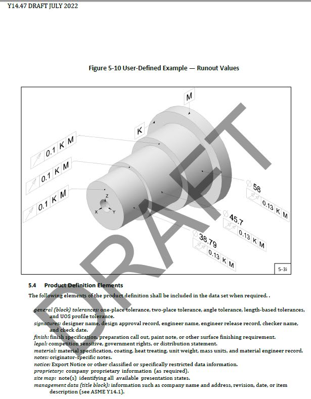

So you are in favor of a solution equivalent to the Intersection Planes of ISO 1101-2017 to be implemented in Y14.5?
New draft of Y14.47-202x is at least consistent with the theory. Doesn't it?
