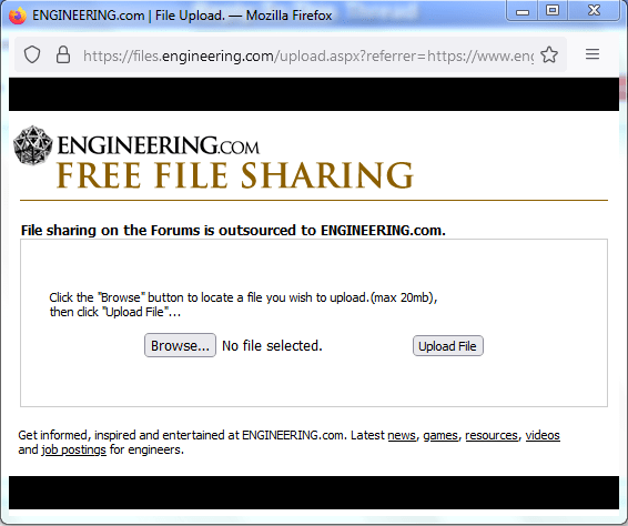

I use the following which uploads to Eng Tips.
People usually forget to click the button to add it to the posting.
