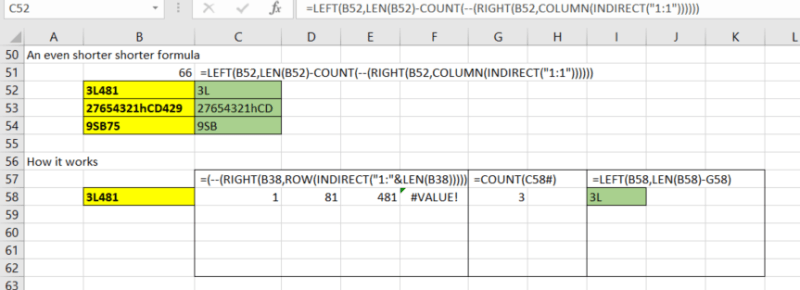

I have broken down the latest variant as before.
To get the =--(RIGHT(B58,COLUMN(INDIRECT("1:1")))) to display in older versions of Excel (without dynamic arrays):
- Enter the formula
- Select the cell and the three cells to the right
- Press F2 then Ctrl-shift-enter to return it as an array
In the latest version you have to do the same thing with the COLUMN formula, because it displays as SPILL if entered with just Enter.

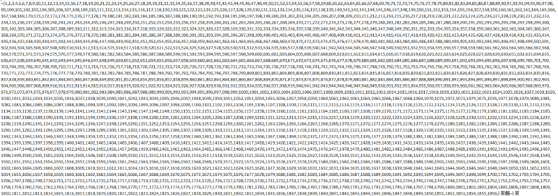

The reason why can be seen in the screenshot below, where I have entered =COLUMN(INDIRECT("1:1")) then pressed F9:
The column formula returns a single row array with 1856 sequential integers, followed by a couple of indecipherable symbols.
For that reason I prefer the slightly longer version, using ROW, which returns a column array only as long as required, and works for me in both latest Excel and Excel 2010.

I tried to reproduce the "SPILL" error and to get that screen shot; when I select INDIRECT("1:1") / F9 it produces an error; formula too long
whether there is a ROW or COLUMN outside it.
