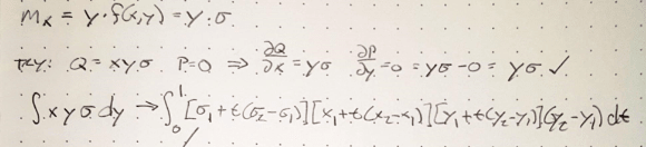

Formulas for Mx and My are found in a similar way:
Knowing that Mx = Force * some y distance and force = stress * area
then Mx = dbl integral y * F(x,y) dA = dbl integral y*F(y) dA = dbl integral y*sigma(t) dA
Green's Theorem substitution:
Q = x y sigma(t) --> dQ/dx = y sigma(t)
P = 0 --> dP/dy = 0

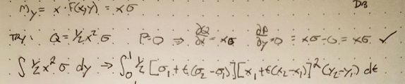

Knowing that My = Force * some distance x and Force = stress * area
then My = dbl integral x * F(x,y) dA = dbl integral x*F(y) dA = dbl integral x*sigma(t) dA
Q = 1/2 x^2 sigma(t) --> dQ/dx = x sigma(t)
P = 0 --> dP/dy = 0
Solving all of the above integrals will give you general formulas for P,Mx,My of an arbitrary line segment.
