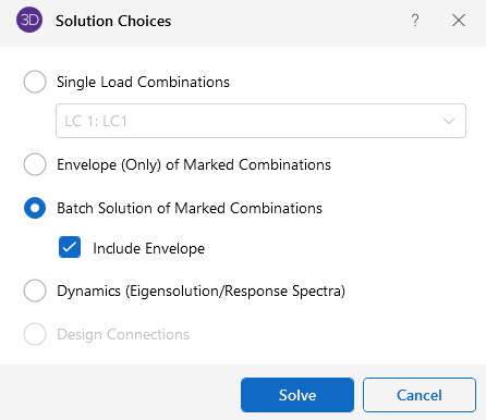

Simple question, I know I can disable some load cases for design operations, this is good, but I also don't want to see those same load cases in my envelope results. Unfortunately, I have found no way to do this.
There is an option when running the analysis to "Envelope (only) of Marked Combinations" but this actually just solves all the LC's and throws away the individual LC data, giving you only the envelope.
I can either turn off those load cases entirely, make a new model without them, or dig into the individual LC results to find the real numbers I need. I wish there was a better solution.
Thoughts? Thanks!

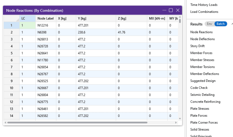

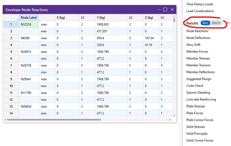

It sounds like you want to use "Batch Solution of Marked Combinations". This will solve all marked LCs, and it allows you to toggle between the filtered envelope and the entire LC batch:
Agreed with the above poster. Have the solve box checked for the LCs you want to run, and not checked for the remainder, choose batch solution and ensure include envelope is checked. That will give you all the LC results for the chosen cases, and also an envelope.
I meant to state in my OP that I always use the Batch Solution, which is explicitly not a solution to my request.
Batch includes all calc'd LC's as well as an enveloped solution. So if I want to run all of my 1.0D, 1.0L, 1.0S, 1.0W, 1.0E, 1.0Ice, etc load cases, those are always included as part of the envelope, even tho I can turn them off while designing, it always includes them in the envelope. This is not an issue when designing with LRFD as 1.0 loads will never control and never be the max for the envelope, but for an ASD analysis, 1.0W and 1.0E will ALWAYS control over [1.0 or 0.6]D ± 0.6W.

EDIT: Apparently I cannot edit the OP anymore, weird forum policy.... So I can't reference the OP back down to this post. Anyways, I'm pretty sure there is no way to be able to run a single analysis to show all the info I want, even tho we are SOOOO close, it's just not something the programs allows. Wish it just had envelope follow the Use For Design checkbox, that's all I would need to happen.
