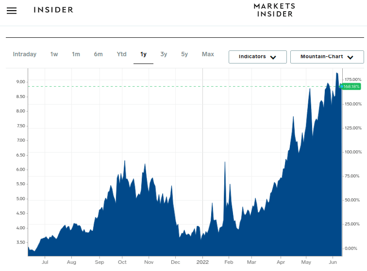

Finally some good news. This might help cool off domestic energy prices a bit.
Some background on the Freeport LNG plant.
How Michael Smith Built A $14 Billion Natural Gas Plant In Texas | Forbes
Looks like the downward pressure is smaller than we hoped, or perhaps the market takes longer to react.
A/C season is beginning in US. I doesn't look like anybody is planning on using less A/C in the expected hotter weather. 3 weeks down time isn't going to affect this market with anything but up pressure everywhere.
That chart is a slowdown in the rise before a top breaking up. No signal of decreasing price anywhere in that. Drops after middle peaks are decreasing. Plenty of upward pressure to spare. You need three peaks at the same price level to have any significant drop. All arrows are up.
