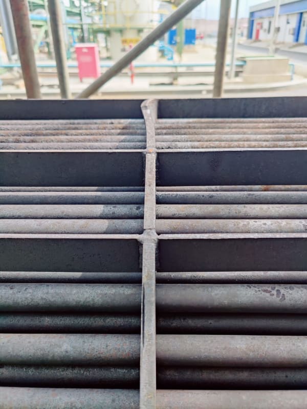

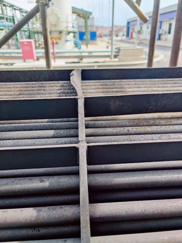

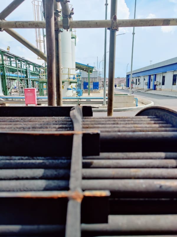

we are facing the problem that we can't remove the bundle of our horizontal shell&tube heat exchanger. Weight of bundle is 9t. Design floating head (drawing attached).
Problem: hx has severe fouling and is leaking. Leaks are expected to be caused by uneven thermal expansion due to debris collected between the baffle plates and reducing heat transfer (pic), mechanical stress as we have non corrosive fluids (hydrocarbons).
Assumed reason that bundle stuck in the shell:

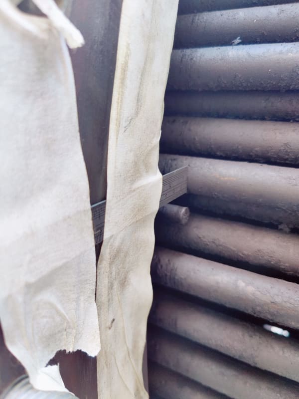

Solids (coke) has has settled down at the botom of the shell between the baffle plates (high and tolerance of baffle plates to shell is to small. Bundle can't be moved at all.
We tried to pull with 16 t forklift, used hydraulic jack at floating end to push it and to break it loose - no success. There might be also a deformation of the shell due to uneven heat distribution since we expect a lot of residue (coke - pic is from different unit) has settled at the bottom so free tubes have a different thermal expansion than the covered tubes.Chemicals doesn't work as coke is quite inert to most common used chemicals
We will try once again with larger hydraulic jacks to break the bundle loose and then pull (see right side of marked drawing). If that fails we will need to cut the shell. Red marked cutting of a window is not suitable acc to the vendor as the shell will collapse once the section is welded back (heat impact and shrinking - many attempts failed with other clients). They agreed to follow the green marked strategy to cut the shell in 3 pieces. But even then rewelding will be a challenge. Please note that only the pic with tubesheet (leaks) is the particular unit. The other pics are from an other unit but we were able to extract the bundle. Any suggestion? Thanks in advance

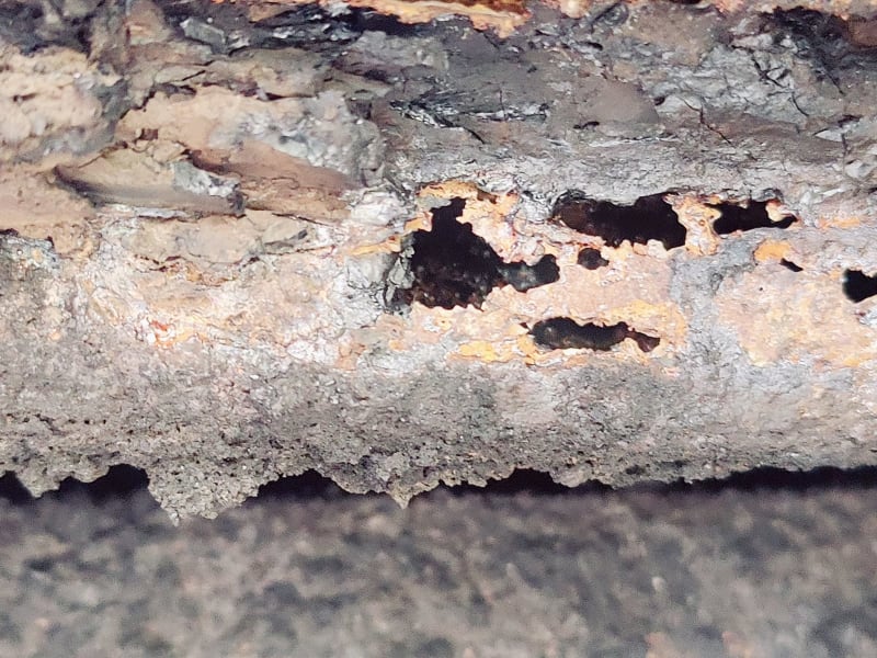

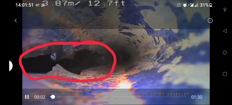

I will go with hydraulic jack 50 t and support-frame and will push it from the floating head side. Once it can be moved 100-200 mm then we can pull it. But anyway....this is just the beginning. We will have to clean the bundle and investigate the cause of the leaks (so far 23). Anyone has an idea what can cause such leak as shown in pic? Pressure not exceeding 9 bar. Tubes are 25.4 x 2 mm SA 179
This is just 1 pic with left side large hole.
I am still thinking of mech. stress due to uneven thermal expansion but side walls are looking like overpressure inside of tube. Also leaks happened almost same time. Problem was only recognized when level of 1. column could not be maintained but level of 2. column increased. That indicated the leakage of more than 1 0r 2 tubes. (Still need to check trends which might identify wrong operation)
Corrosion can be due to localized overheating by uneven thermal expansion caused by the coke fouling. Wish you good luck|

One of the problem seems to be obvious at the 3rd unit we could actually pull. The baffle plates were made with too small tolerances. The shell has a light deformation on the top where the lifting lug is welded at the shell. When the manufacturer installed the bundle, the baffle plates were already bent (Easy to see since the direction shows it)
Lesson learnt. Keep 3 mm gap between shell and baffle plate. At least if you run with products which require regular cleaning of shell side.

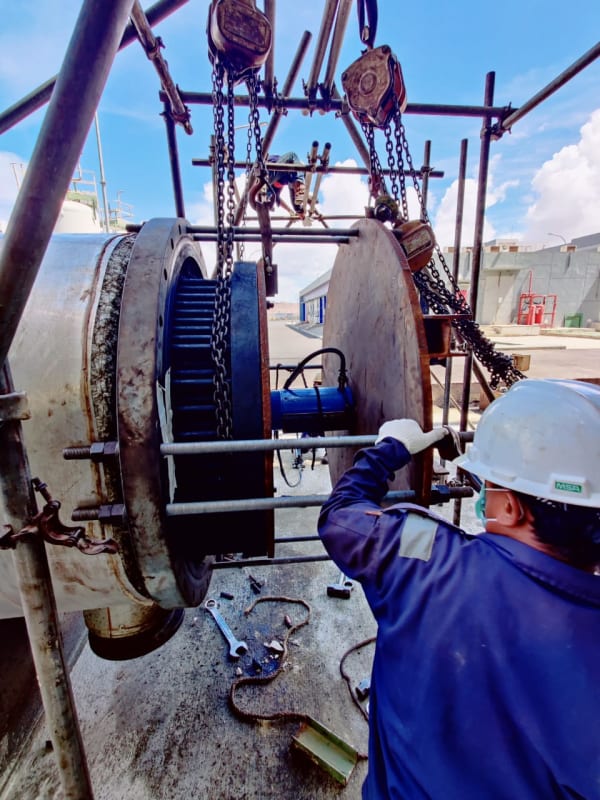

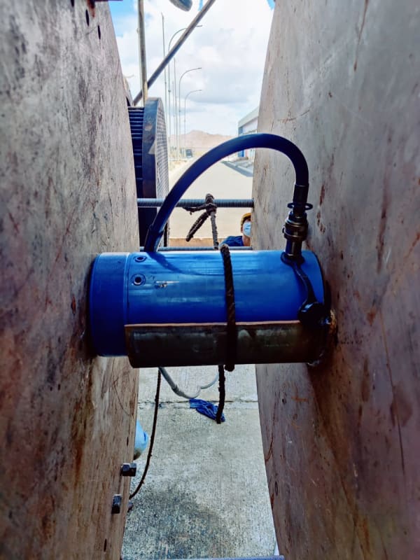

So here we go, finally I had time to loosen up the bundles. How did we do it?
1. Pulling didn't work so I decided to push it out with a 100t hydraulic jack
2. Built a structure with a 20 mm plate to protect the tube sheet, and a reinforced 24 mm plate as counter part.
3. Used 8 long stut bolts to balance the forces on the shell flange
5. Welded a support on the plate to support the 30 kg jack
6. Installed marker for the progress of movement
7. ....starting pumping up. Once the pressure was to high the bundle made a 20mm jump and was freed.

Need retubing now since many damaged tubes can be seen. Corrosion might be the reason due to chem reaction of solvent. Acidity might have not been considered correctly in the design of the heat exchangers. Need to send samples to metallurgic lab to confirm.

Stefan - to clarify, you used a hydraulic jack to push the bundle towards the shell side to loosen it, and after it moved you were then able to freely pull it all the way out?
TiCl4, I havn't pulled the bundles yet but it will be done this week. It is loose and easy to pull now. It has tremendous coke deposits and was actually cemented in the shell.
