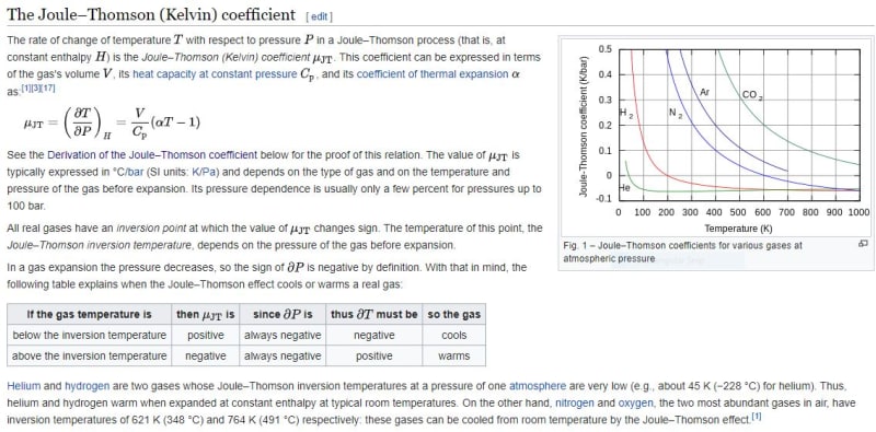

I tend to try to understand all the fundamental underlying theory, so I was studying the wikipedia page on Joule-Thomson expansion effect closely in detail, because as I understand it, that is essentially the fundamental expansion that we see in compressible flow, which we've been discussing in this thread (yes, I understand that gas flowing in insulated pipe isn't as clean of an example of this effect as flowing across a throttled valve as this flowing in uninsulated pipe isn't quite adiabatic/isenthalpic but the effect is still in play at a milder level). I was confused by something in this section of the wiki page ->
"In a Joule–Thomson expansion the enthalpy remains constant. The enthalpy, H, is defined as H = U + PV where U is internal energy, P is pressure, and V is volume. Under the conditions of a Joule–Thomson expansion, the change in PV represents the work done by the fluid. If PV increases, with H constant, then U must decrease as a result of the fluid doing work on its surroundings. This produces a decrease in temperature and results in a positive Joule–Thomson coefficient. Conversely, a decrease in PV means that work is done on the fluid and the internal energy increases. If the increase in kinetic energy exceeds the increase in potential energy, there will be an increase in the temperature of the fluid and the Joule–Thomson coefficient will be negative."
That PV increase being referred to in bold.. this is how I'm interpreting it (please correct me if this is wrong): If P1 and V1 are 100 and 75, respectively, and P2 at some downstream location is 50, then V2 will have to be higher than 150... in which case, PV has increased due to the PV expansion work having done by the system. If PV is said to be constant in isothermal flow, meaning it could only expand up to 150, how could the PV increase in adiabatic flow? Shouldn't there be smaller expansion in adiabatic flow? So I would expect PV to decrease instead.
Any idea what I'm misunderstanding here? I'm almost sure I'm comparing to apples to oranges here again but can't pick out what exactly.
Sorry if this is a bit too esoteric/theoretical. You guys have been very helpful so far.
The IF, in front makes me think they are talking hypothetically and not about a specific case. This is supported further down before their "proof" with the discussion on a gas changing sign of the JT coefficient before/after it's inversion point:
They are covering all the cases, not just the usual expansion with a drop in temperature we see in compressible flow of most gases and vapors. I think from that respect what they say is correct.

Sure I'm willing to assume they're trying to cover all cases. But the thing is, I don't even see where they cover the usual case of temp dropping AND PV decreasing anywhere. The only time they talk about PV decreasing is here:
"Conversely, a decrease in PV means that work is done on the fluid and the internal energy increases. If the increase in kinetic energy exceeds the increase in potential energy, there will be an increase in the temperature of the fluid and the Joule–Thomson coefficient will be negative."
This doesn't seem to be the usual case because in the usual case the fluid would be doing the work (rather than not getting work done on) and thermal kinetic energy (temp) decreases rather than increase.
Something is not adding up here on a semantic level..
Let me ask you this in case we've got the semantics flipped: When a fluid is doing (expansion) work as opposed to getting work done on, would the PV value in H=U+PV increase or decrease? And during the usual expansion in compressible flow, is the fluid doing the work or getting work done on?
That PV increase being referred to in bold.. this is how I'm interpreting it (please correct me if this is wrong): If P1 and V1 are 100 and 75, respectively, and P2 at some downstream location is 50, then V2 will have to be higher than 150...which represents the PV increase.
BUT if PV = constant in isothermal flow meaning it could only expand up to 150 (V2 = 150), and if PV[sup]k[/sup] = constant for adiabatic flow meaning PV itself would decrease (i.e., P2*V2 < P1*V1) and so V2 wouldn't be as high as it's in the isothermal case...HOW COME the wiki quote says that PV increases suggesting that V2 would actually be higher than it's in the isothermal case? How could the PV increase in adiabatic flow? Shouldn't there be smaller expansion in adiabatic flow? So I would expect PV to decrease instead.
Can anyone tell me if my question makes sense please? I'm not sure if the question is incomprehensible or if you guys aren't sure of the answer either.

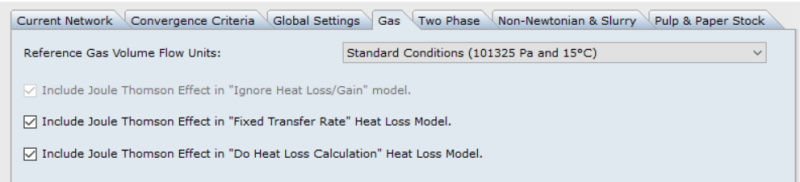

Directly to your comment: I also thought initially that the Joule-Thomson (JT) expansion effect only applied to valves only as the heat transfer is negligible in that scenario. But after diving deep, I learned that JT is actually in effect in any conduit that is adiabatic. So if a pipe is perfectly insulated the JT effect is working EXACTLY the same way there throughout the whole pipe. In fact that's not even the full picture...in reality, even in an UN-INSULATED pipe the JT effect is happening...it doesn't have to be adiabatic...only difference is that the effect is milder (you don't see as big a temp change). So adiabatic will show the purest, cleanest and maximal JT effect and non-adiabatic (polytropic) will show a lesser JT effect and isothermal will effectively show none.
I say isothermal will effectively show none because just like polytropic and adiabatic, it will also cool, as it flows over a unit length of pipe. Why will it cool? Because as the pressure drops it has to cool in order to expand -- since this is a real gas going against pressure, there is no expansion possible without JT effect of cooling (as per the mechanism described above). So the reason this is ending up as isothermal effectively is because of the heat transfer which raises the temperature back up. So my point is that JT expansion is not fundamental only to adiabatic flow. It's just that...effectively that is the flow that sees its maximal impact.
Again, for a real gas, JT expansion is inherently built-in to the entire flow, not just across the valve. There is no flow without JT expansion, whether that cooling is being "reversed" by the heat transfer/input that may also happening at the same time (isothermal) or not (adiabatic). This was a big revelation to me. Hope that makes sense.
The sources that made this particularly explicit/clear to me:
1) My flow simulation program: It automatically does the JT calculation across a valve. And if you select the adiabatic model for the pipe as if it's perfectly insulated, it again automatically includes the JT calculation. It won't even let you uncheck that calculation. If you select a non-adiabatic (heat transfer) model for the pipe, then it lets you check or uncheck the JT calculation. See image below.

I think the PV quantity in the enthalpy equation H=U+PV has a slightly different meaning than the PV in PV[sup]k[/sup]=constant.
The change in PV in the former context is at the "micro" infinitesimal level strictly as a means of calculating the expansion work which would take the generic form of W=P*DeltaV. So at the micro level, P is basically held constant as the volume changes/increases (recall back to how you manually would integrate the area under a PV curve). So of course PV would increase in that micro expansion causing U to decrease leaving H constant. This is how PV is used here even though the overall quantity of PV decreases at macro level for all practical purposes because P actually decreases in reality instead of holding constant.
This was really bothering me so I feel much better now. I guess my whole confusion came back from completely forgetting the theoretical basics.
If anyone sees anything off with this, let me know.
