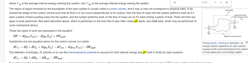

I don't believe V has to necessarily be an intensive property here. It is in h=u+Pv (small case, intensive) which seems to be just as valid/applicable as H=U+PV (capital case, extensive) where it is an extensive property. In the wiki link here, they show it in capitals to represent extensive:
If you scroll down, they do a proof that h=u+Pv remains constant in terms of intensive. So again, I think both are valid. Correct me if I'm wrong.

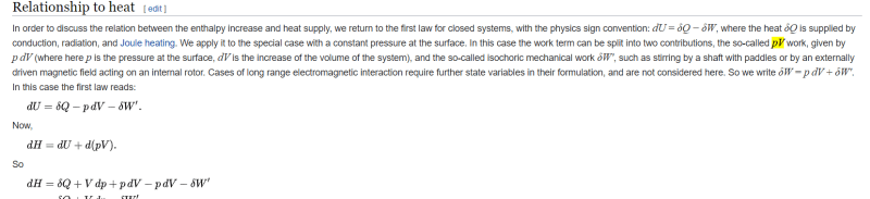

I didn't mean that P and V have separate meanings/definitions between these two contexts. I didn't even necessarily mean that the PV quantity has separate meanings/definitions between these two contexts (unclear wording on my part). But more so that the change in the PV quantity is different between them. If the way you'd calculate PV expansion work was with d(PV) like you're saying (which was how I thought it would be calculated as well as that was intuitive), then there wouldn't be a difference. But actually, it's not calculated that way. See this short webpage:
Or look at Khan academy video here where they calculate it manually through integration of the PV curve. Even though both P and V change, how you calculate the PV expansion is by assuming P is constant for an infinitesimal increase in V and repeat that till you cover the whole area:
The wiki page says that the change in PV represents the net work done by the fluid. Since the fluid does net work here, the magnitude of that PV increase is the amount of net work done.

As for the ideal gas, see the screenshot below from the Joule Thomson wiki page. There is no PdV work done here either. I think it's because there are no attractive forces to overcome so the gas can simply expand enough to match the drop in pressure leaving temperature constant.
Most of the info I'm getting from that wiki page and this page:
