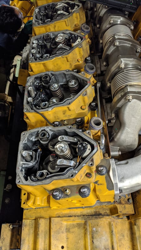

Yes, once the engine gets much longer than 3 feet manufactures start using individual heads per cylinder to mitigate the problems associated with thermal expansion.
Not many 3 footers in F1.
