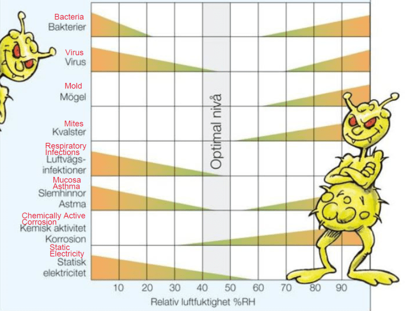

And thanks dik for the translation. :-)
I was a bit lazy, but I see "google tranlate" works from Swedish to English as well.

I just wanted to make sure the titles were what I thought they might be... two of them, I didn't have a clue... Swedish... I thought it was German...
