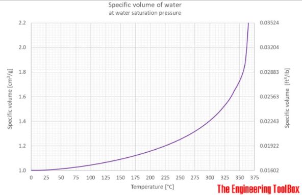

I am not sure if this is what 1503-44 is trying to say that the mass is constant but the volym increases with temperature [ponder]

No. What I have always wanted to say was that size (volume and surface area) of a drop dont matter much. Evaporation rate is overwhelmingly driven by the mass of the droplets and the heat needed to evaporate them. A larger drop will always have a longer life than a smaller drop, because it will always require far more heat to evaporate it and that takes a longer and longer time to accumulate enough heat to do that as drops increase in size. The increased surface area of a larger drop is no help, because the mass of that drop has increased so many times more than surface area and it is the mass that must be heated for a drop to evaporate, not the surface area or volume. Others want to introduce density, say mass is equal to volume, since it has density and claim it was volume driving the show all along. Not true, but if conditions are right, i admit that you might get the same answer.

Actually, we're all waiting for the pedantic individual trolling the thread to actually explain how volume isn't closely related to mass, or how V/rA is the volume to surface area ratio. Remember, within the realm of the subject topic, which is indoor areas where people reside or work meaning the temperature and pressure don't vary much. We won't be holding our breath waiting, that's for sure.
RedSnake - ya probably the argument is due to that curve. But, you won't find most of that curve within an indoor living area. Yes, droplets aren't perfectly round, but I think you'll find that the V/A ratio of most any shape of droplet changes with volume. We should all know how surface area and evaporation rate are related. anyone who doesn't shouldn't be on an engineering website pretending to be an engineer.

For the scope of the original discussion, virus transport near room and body temperature, the density of water doesn't change but 10 parts per million between 4 C and 40 C
Can you explain why the mass of a water droplet is not highly dependent on the volume of the droplet? Remember, within the context of this subject.
