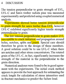

I have a personal interset in this subject, since I am in the midst of desiging a complicated roof framing system and was considering connecting some dormer ridges to a main ridge below the neutral axis. A quick google search turned up this article:
Snip of the conclusion below:
Thanks, JAE... I'm not so sure that glulam beams are an issue. I can see it for dimensioned lumber and timbers...
