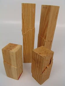

Obviously, any load applied to any member will induce tension stress perpendicular to the grain. This is basic Mohr's circle theory from university. This is why a timber post loaded in compression will have splitting along the line of the grain (perpendicular to the direction of load).

In addition to the above post and as an interesting side note, Mohr's circle theory is also why a post loaded in compression may fail in diagonal shear as this is the weakest plane for the perpendicular/parallel stress relationship.
