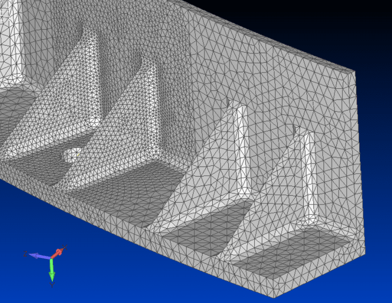

Dear Femap users,
Recently I tried to slice a solid and make a tet-mesh out of the geometry, but for some reason femap did not create a face at the plane of the slice. This makes the solid not enclosed and I am unable to create a tet mesh. Anyone know what went wrong, and how to fix this?
Was there any errors listed to the messages window when the solid was sliced? Femap should normally enclose a solid that is sliced.
No, there were no errors. I repeated this process a few times and still the same result. However I did figure out how to fix it!
I created a boundary surface from the edge curves, converted that to an actual surface, and then performed non-manifold add and it became a proper solid to tet mesh.

I am assuming he used Geometry > Boundary Surface > From Curves and then selected all the curves that made the loop of the open area that was created after the slice. From there you could use Geometry > Surface >Convert, which will convert the boundary surface to normal parasolid surface. Finally you could do Geometry > Solid > Stitch. If the surfaces you select make a "water tight" connection, it will be converted to a solid. Then you will be ready to mesh.
But I am curious of why the original solid slice created an open face.
TG you are absolutely correct on everything youve said, and I think I my first post was misleading to rb1957. My issue was not related to the hole, sorry for the confusion. It was indeed the open cross section (not water tight per TG).
I also dont know why I got an open face like this, Ive always sliced solids in this way and never had such a problem before.

Is a problem of the geometry, all has an explanation, but without the model in hand is impossible to investigate exactly. Please post your original FEMAP model here and we can investigate the reason, thanks!.
Please note if your original solid geometry is not perfectly closed (the geometry is not a genuine solid) then is useless to try to mesh with tetrahedral elements, the TET mesher will fail for sure.
Check FEMAP in your MODEL INFO tree the icons you have for the geometry: the genuine solid is a cylinder. If the icon of your part is different, then you have a problem, the component is simply skin, a collection of surfaces. You can create a genuine solid body creating the missed surfaces and stitching all surfaces in a solid BODY using command GEOMETRY > SOLID > STITCH:

Blas, you were right! Unfortunately I did not save a version of the model which still contains the geometry so I was not able to check what you said. However I did try and import the geometry into a new blank file and saw exactly as you had described. The icon in the tree was NOT a solid cylinder. Thanks for your great explanation.
