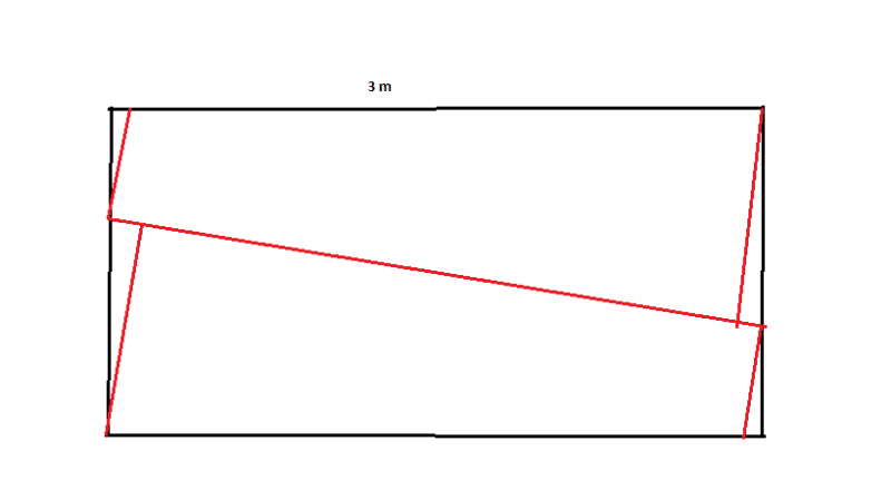

What about other plates ? Did the owner supply only pontoon plates?
My opinion is ,if you want to optimize the wt of steel plates, obtain four bulkheads from each 6(m) x 1.5(m) plate ... You may use the pontoon width 2.8 m without significant waste for bulkheads.. Moreover, the total wt will be 11 tons less..
