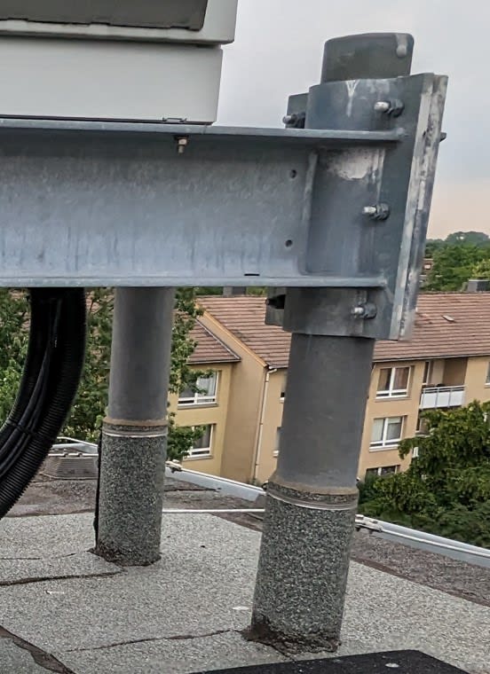

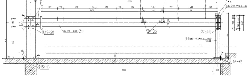

The picture ( waterproofing patches around legs ) implies the framing of the roof top units freely supported on flat roof and probably the ftgs are PC or flat plate supported on heat insulation.
Apparently , the supports ( joints 1,10,22,28 ) are pin and the others rigid connections. You cannot provide fixed support conditions here wright?

Now, can we talk about that extended end plate moment connection to the pipe column? That's a nifty bit of connection design.

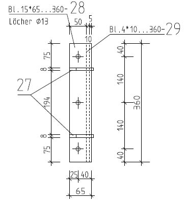

It doesn't look like a moment connection to me. Looks like a stiffened clamp. I don't really like it because it seems to be relying 100% on friction, unless there's welding there that I can't see.
It's missing a couple bolts to fit the 'normal' configuration, but as long as the backside is welded to the column I think it could work. I agree, though, that it is pretty sketchy if it's 100% friction.

They can be fixed or pinned... I'd usually use pinned to force the moment connection to the post and the beam over; it's likely a lot easier to accommodate. The moment comes from the lateral loading on the equipment plus what appears to be a large eccentricity.
What's it actually supported by? Before you assign a lot of moment at the base, you have to know how that will be developed. From the sketch, it looks like a few short pins connect it to a thin slab. If those drilled in anchors are going to pull out, it is foolish to depend on fixity. Too much modeling, too little common sense.
