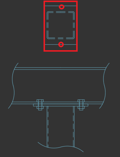

It depends how you design your connections. A sketch would help enormously.
Do you have to transfer the load evenly to all four sides of the HSS? There is no such thing as a perfect pin joint so you should be designing for at lease a nominal eccentricity in the connection.
If necessary simply design and detail it as a rigid connection.

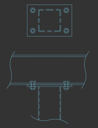

sdz, here is the connection in question:
On one side of the connection, the beam cantilevers. On the other side, the beam spans over to another column and connects with a similar cap plate connection.
I think that this would be closer to a pinned connection than the drawing you provided (in the frame plane of course). I don't know if this impacts constructability since I'm more of a concrete guy.
hardbutmild, the only way that could be accomplished would be to clamp the plate onto the bottom flange. The HSS tube section is 6 inches wide, and the bottom flange is 8 inches wide. That only leaves an inch of plate between the edge of the tube and the edge of the flange, which would not satisfy edge distance requirements for a bolt of any reasonable size.
I thought that was the situation, but since it wasn't clear I figured I'd suggest it in case you haven't considered it.

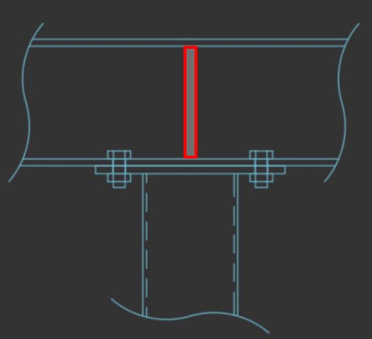

Well, I have one wild idea that might work or might be a complete miss. I won't explain it in words, since I think the picture says it better. The weld seems short in picture, but obviously you need to calculate it.
