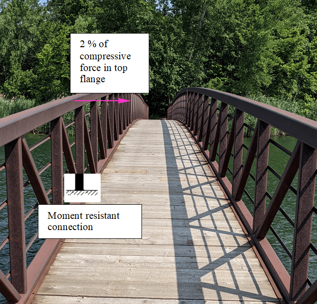

Those verticals and diagonals are not pure pins. The are semi rigid or rigid moment connections. If this wasn't the case then leaning against the top cord railing won't cause it to rotate around the axis of the bottom chord. That stiffness is sufficient to reduce the effective length of the top chord significantly.
(I recently designed a truss like this. The effective length calculated through buckling length calculation reduced from 20m down to about 3m. The spacing of the verticals was 1.1m. I ended up not going ahead with the design. It was simple to just have an underslung truss braced in a manner like you've shown with separate handrails.)

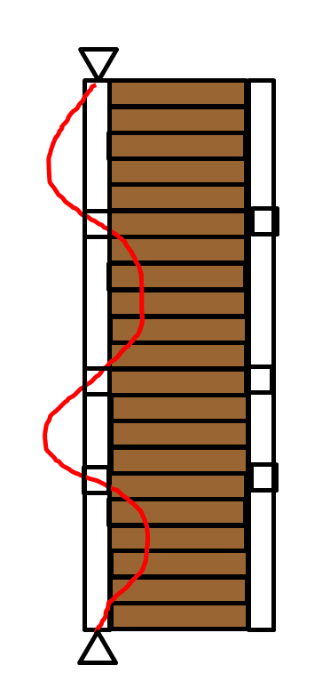

Are you talking about this length that can be reduced?
If so, how can the stiffness reduce the effective length? I would have thought that only a crossframe or diaphragm at some interval would been sufficient to reduce the effective length, like this:
Did you take 2 % of the compressive load and verify if the moment connection at the bottom chord can resist that?

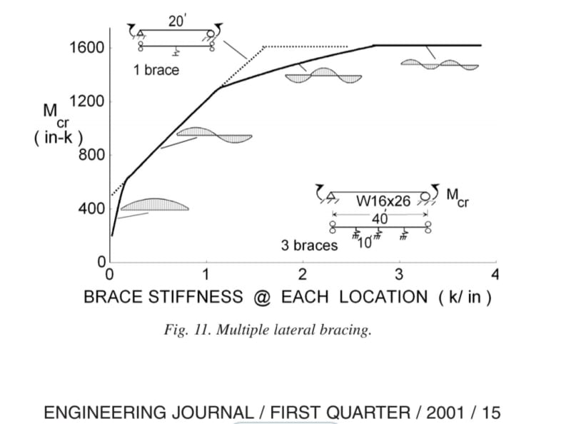

Logan, the U-frame made of the vertical posts and the cross beam under the deck results in a lateral stiffness at the top chord. It will be less stiff than your cross bracing but adequate to increase the buckling capacity (= reduced effective length). In the image, there is a stiffness which results in the effective length being the distance between braces and making the bracing stiffer doesn't increase capacity further. At lower stiffness, the half-sine length of buckling is longer than the distance between braces but still increases buckling capacity compared with no bracing. This is how U-frames work (aka pony trusses).
From Yura's paper "Fundamentals of beam bracing".

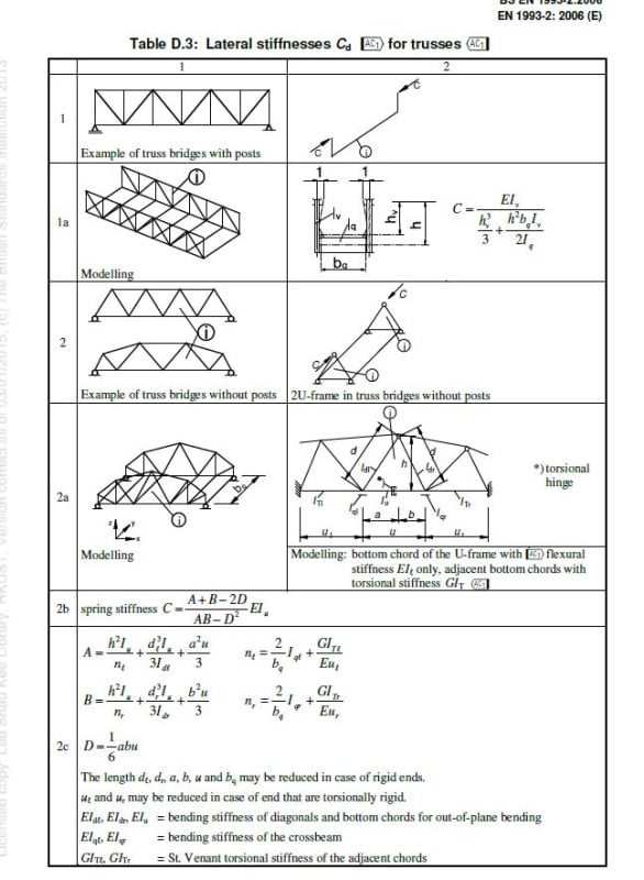

The compression chords of open bridges may be modelled as compression elements with lateral supports provided by vertical struts and diagonals.
BS EN 1993-2:2006 ( Eurocode 3-2 ) appendix D Table D.3 gives the formulas for stiffness of the lateral supports which may be used to determine .
The excerpt of the same page attached ;

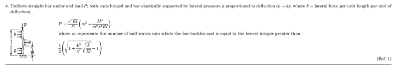

As other repliers have pointed out, your upper horizontal "hand rail" beam is laterally supported against buckling by the lateral stiffnesses of the tips of the U-frames.[ ] This stiffness is finite rather than infinite, but it draws its effectiveness from the fact that there are multiple such stiffnesses at regular intervals along the run of the bridge.
If the lateral support stiffness provided by each frame is K [in units F/L] and the U-frame spacing is S [units L], you can convert the overall lateral restraining stiffness to a value of K/S [units F/L²] applied continuously along the handrail.[ ] This converts the problem to that of continuous beam supported on an elastic foundation, for which there are "standard" formulae for the buckling load.[ ] See, for example, Roark's Formulas.[ ] In my fifth edition of Roark it is Table 34, case 4, in the chapter "Elastic Stability".[ ] However there is an error in the formula he gives, where the exponent applied to pi in the denominator of the second term should be 4 rather than 2.[ ] See Roark's reference #1, Timoshenko, for evidence of this assertion.[ ] (I notified the publisher of this error, and I believe it was fixed at some stage.)
Making the further simplification that the handrail is near enough to infinitely long, an assumption that is easily — and should be — confirmed/negated, Roark's (ie Timoshenko's) formula (after the above correction), reduces to
Pcrit =2*Sqrt(KEI/S)
The corresponding "half wave length" of the buckled shape is
pi*(EIS/K)^(1/4)
and this should be checked to verify that each half wave includes enough U-frames for the "continuous lateral support" assumption to be appropriate.
Hi Denial, interesting! Looking in the 7th edition, it looks like they did the modification you were talking about with pi:
pi*(EIS/K)^(1/4)
Where did you get this formula?
In Roark, it says: "both ends hinged". It implies that the end conditions of the top chord are pinned like this:
(view from the top)
How do you make sure the U frames at the ends of the bridge are sufficiently stiff to make sure that the tips of the U are restrained in the horizontal plane?
Another question: say that there are no intermediate U frames, the only U frames are the supports. The effective length = the total length. Would you say there would be a minimum stiffness required for the U frames at the supports? If so, what would it be?
