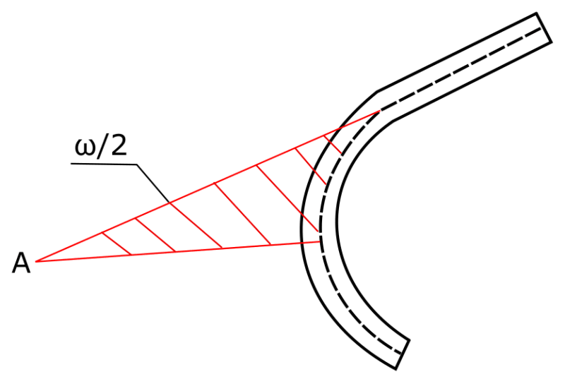

If you are interested in the fundamentals behind calculation of the warping constant and warping functions, I believe Robbies program uses this text as its basis for the computational methods.
About all I remember from university is that the warping constant is the evaluation of the following integral (I think!) ∫ω²dA, where ω is the warping function, which I cannot remember exactly what this is or how to derive it to be honest, but it got pretty complicated I remember!
So best to go to some recognised text like that linked above for further info on the theory, as I'm no expert in the underlying principles by any means.
The FEM method I reference is simply a method for numerically evaluating these fundamental integrals for a given geometry.

In the previous post I said that I will find the source of the formula. And I've found it. It's from the Polish book titled "Ksztaltowniki giete. Poradnik projektanta" (Cold-formed sections. Designer's Guide) by J. Brodka. This book also features a nice definition of warping function which I am going to translate and share with you since it's really hard to find good definitions regarding this topic and Agent666 mentioned that he's not sure what ω really means. So warping function is actually an area of a sector. If you take the middle line of an open section of a beam then warping function can be defined as "doubled area of a sector bounded by considered section of the arc and two radii drawn from shear center A to the points at the end of the section". I know it may sound complicated but the picture should explain it all:
