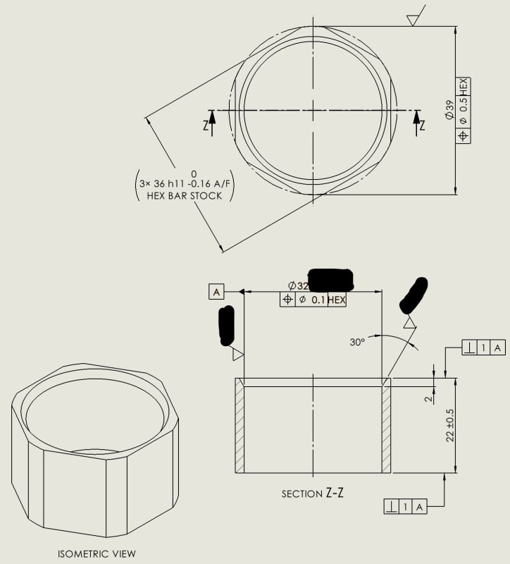

Hi all,
I have a simple part which has a machined bore which must have its position controlled relative to the external hex of the bar stock (if viewing it from the machinist's perspective). We've been having trouble discussing this internally and have tried multiple different approaches, none of which we're satisfied with. I've attached a screenshot of the drawing as it stands (with several unimportant redactions).
I've seen numerous forum posts of hex features being controlled relative to a diameter using profile on the hex, but that can't apply here as the hex isn't machined, so has its own stock tolerance, and the position of the bore must be tighter than the stock A/F tolerance on the hex. On the drawing I've indicated what I want to achieve, functionally, via the position tolerances with the hex as the datum (I understand this is not OK!), but if there's a suitable solution where the bore is the datum and the position of the hex is controlled regardless of size, that is also fine in my eyes.
Any guidance on how best to detail this will be greatly appreciated!
NB I'm aware that the h11 tolerance on the hex is strange, but that's how the supplier (Parker steels) tolerances it!
Many thanks,
James
 https://files.engineering.com/getfile.aspx?folder=d1a9163c-1a09-4d72-ab14-2fec29e182ae&file=Hex_Bar_Stock_Bore_Position_Problem.jpg
Sounds like something that could be handled using the dynamic profile modifier, 'Δ,' after the profile tolerance value. Which standard and year of issue are you using for dimensioning and tolerancing?
Nothing strange in h11 on bar stock becasue cold extrusion is a fairly precise forming process. Round bars usually come in h8 stock tolerance so h11 is no big deal either.
There are three pairs of opposing flats, so make each pair a datum feature and then create three position tolerance feature control frames for each of the features, one to each of the datum features; this will not use a diametral tolerance.
This will best center the round feature axes to each of the three pairs of flats, Regardless of Feature Size (RFS), even if the widths differ and even if the angles are not precisely 60/120 degrees apart. It will also match how this could be aligned in a lathe.
It may also required to use CF (continuous feature) symbol on the outer diameter position tolerances.

CheckerHater said:
As you already use DIA 32 as the datum feature A, do you think you can reverse your position requirements?
- Yes, more than happy to; I just want whatever GD&T is clearest to indicate the position requirement without adding in any nasty inspection.
- We like this, and it feels intuitive to interpret. Thanks a lot for the detailed explanation!

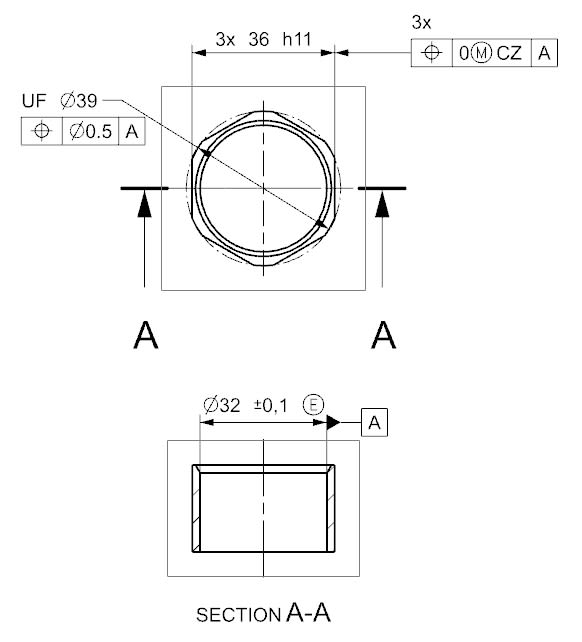

Hi James,
I would keep datum "A" as the center line of the bore and tolerance the the outer diameter as UF Ø39 with a position tolerance with respect to "A". I have not done this my self, but for a hex I have seen the following approach being used; 3x 36 h11 with a position tolerance at MMC and reciprocity requirement.
Something similar to the attached figure. I can´t seem to find the correct circled "R" in my version of NX, so it shows the equivalent Zero tolerance at MMC instead.
You need CZ to evaluate the 3 mid planes together with fixed TED angles within the group.
