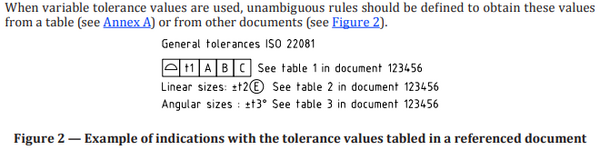

I am working on a new titleblock with better notes and layout.
I was thinking to have this note specified for the general tolerances. Any suggection for improvement?
TOLERANCES UNLESS OTHERWISE STATED
- GENERAL: ISO 2768-mK
- THREADS PER ASME B1.1: 2B/2A
- THREADS PER ASME B1.13M (Metric ISO): ISO 965-1 6H/6g
Any feedback is appreciated
ISO 2768-mK is a reference for both untoleranced dimensions according to ISO 2768-1 (m class) and unspecified geometric tolerances according to ISO 2768-2 (K class). However while ISO 2768-1 still seems to be Intact, ISO 2768-2 is withdrawn, and was replaced by ISO 22081:2021.
Take into consideration of your thread callouts, if you use Zinc, or plating on your threads. If you really want -2A after plating, or coating, there maybe a cost associated with this. something to think about.
I would callout also ISO8015:2011. Maybe ISO1101:2017. --for clarity purpose only--.
I know, some people could argue that my recommendations above are redundant in ISO GPS, but anyway......this is not the hill I want to die on.
