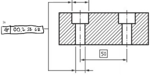

So should I understand that shown CZ will link all 4 inside diameters (2 c'bores and 2 thru holes) together and if we would like more "relaxed" specification then we have to use SZ CZ option?
I am asking how would you link only c'bore with its corresponding thru hole and NOT between the patterns (pattern means C'bore+thru hole). Again, using only one tolerance indicator (as shown above) if I add SZ preceding CZ, would that "solve" accordingly per my inquiry above?

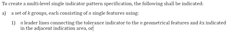

greenimi, I believe using SZ CZ alone is ambiguous because there's no rule that say's which holes form which pattern. My suggested notation would be:
It complies with this clause a(1) of Rule E from ISO 5458:2018 which specifies allowable methods for indicating a multi-level pattern. There are no examples in the standard of this exact method:

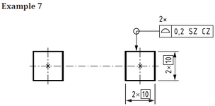

Here is the closest example from the standard.
In the standard it is shown that the location is pairwise coaxial thus linking the Cbore and hole. Hope i am right ?
