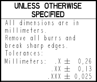

Looking for a standard which will help me define what we should be putting down on our SolidWorks drawing template when it comes to general Linear and angular tolerances.
Currently as follows in mm:
X: +/-0.25
.X +/-0.1
.XX +/-0.05
.XXX +/-0.010
Which standard should I be looking at in terms of ISO standards?

Below are some general tolerances on some of our customers drawings.
Finglas, if you have a copy of the ASME Y14.5 standard, read the paragraph for millimeter dimensioning. In the 2009 edition, see paragraph 1.6.1(c) and in the 2018 edition see paragraph 4.3.1(c).
Unlike inches (which are explained in the subsequent paragraph), when using millimeters it is forbidden to have any extra zeros after the last digit to the right. The drawing cannot display values of 12.00 or 12.000.
Thus, when using millimeters you cannot have a title block tolerance method which relies on the number of decimal places (unless, I suppose, you ensure that every dimension ends in an artificially induced digit that isn't zero).
So the general tolerance tables from your customers would not be proper (except the DIN 1688).
I know this rule was already mentioned by dgallup and CheckerHater. Your examples illustrate how common this practice is in industry.

I am amused by the mixing of the "." and "," notation in the last example image.
