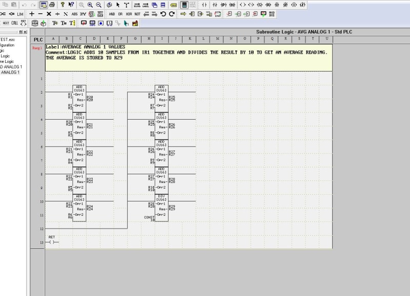

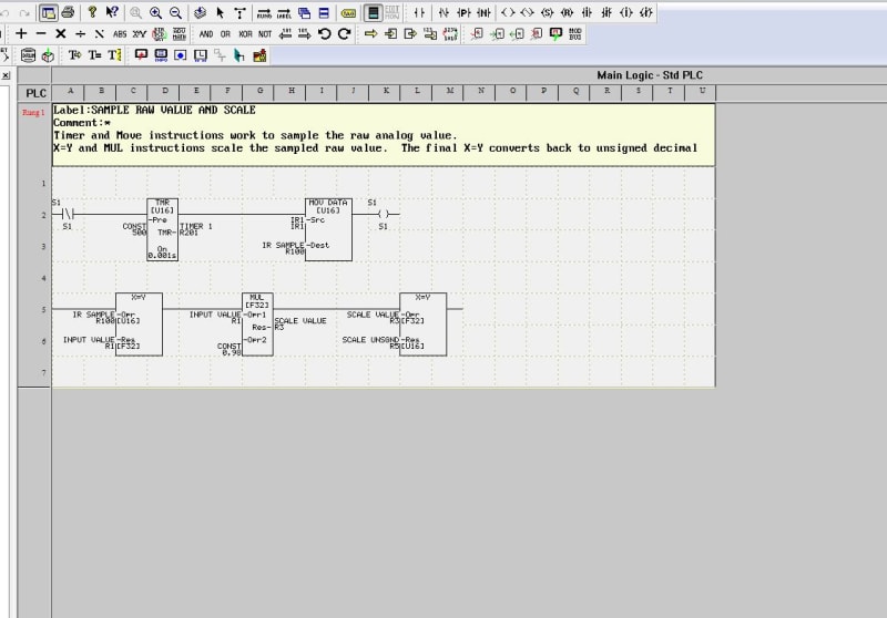

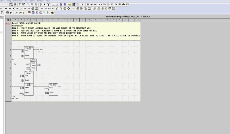

Over the weekend I did some more studying and it has dawned on me that I will need to create a new rung to be able to scale the output signal to the motor for total sped control. The line that I initially thought was for output scaling is actually for rate of velocity increase (line 9 of rung 2 of logic sent Aug 8th). The way that the EZ420 does scaling is a little different ( I have attached a screenshot of the example tech support sent to me). My question is "based on the logic that I attached on August 8th (power panel project) would you agree that I need to add a rung specifically to scale the analog output signal and if so would it be best to do it before or after my "motion" rung (rung 7). My thought process is to put the motor scaling signal rung right before motion rung (rung 7)so that during scanning the program the signal will be scaled as necessary prior to the motion rung (and subsequent outputs) being read and would also make sense based on the program "doing all logic prior to outputs". Currently the logic goes in these steps, calculations, timers, process timing, motion and braking. I have attached a pic of how the EZPLC does analog scaling, if I understand correctly the "IR1" source in the scaling example will be my "OR2" (analog out inverter), that "U16" value is converted to a floating point 32 bit value, that value is then multiplied by the "scale value" (I need 3000 RPM from a 16 bit module, my slope is 3000/4095 = .7326). I am not sure why the final "X=Y" conversion is needed to convert back to unsigned decimal. I have also attached a couple of pics concerning reading and averaging the analog signal, I am not sure if this logic somehow ties in or not but wanted to throw it up there in case it does. Any insight into this latest info is sincerely appreciated and if necessary I am willing to pay for some tutoring via a teamviewer session to get this project over the top.
. Again, thank you for your time and have a great day!
