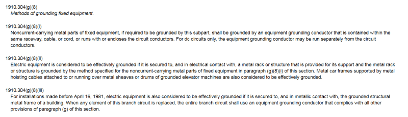

There are a couple of old plants in our fleet that were apparently built without wire type EGCs for some voltage levels. In some cases the raceway system may serve as an EGC but this is more by coincidence than by design. And in those cases bonding between raceway and enclosure or raceway to raceway is definitely sub par with respect to today's requirements. For the electricians that work at those plants and that's all they've ever known, they believe a connection to the plant's buried/encased grid to be an excellent means of grounding. I need to find a way to teach them that an EGC is both necessary and superior. I'm kind of curious when and EGC with or around the circuit conductors became an NEC requirement. Anyone know? The oldest NEC version available for viewing on NFPA's website is 1968 and back then it was a requirement. Although, in both the 1968 and 1971 versions it says that equipment connected to structural members are considered grounded. The 1978 version clarified that a connection to structural members is not to serve as the required equipment grounding conductor - perhaps that was a point of confusion back then. It wasn't until the 1999 revision that the statement about a connection to the structure went away.
cuky, I think applicability of certain codes is dependent on your state, county and city. If you know of something that says the NEC is applicable to power plants at a federal level I'd like to learn about this. Definitely OSHA is applicable though. Note the exception for installations prior to 1981.
