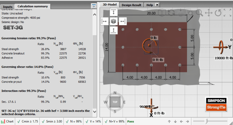

Graph below show result from Simpson anchor bolt calculator. Make sure you have adequate edge distance and embedment depth. I assume you have reinforcement to prevent tension pull out, but not for shear.
JLNJ - yes you are right,the failure mode is concrete breakout so I guess I am going to submit the report as is to EOR, with my numbers and they have to confirm slab design on their end..
retired13 - thanks a lot for taking the time to check it. I didn't know they have their own software. Will look into that

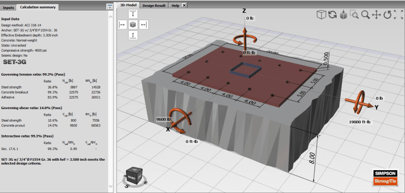

The revised layout. Note, concrete breakout controls the design. I will do a hand calculation in order to better utilize the reinforcing steel. The Simpson design tool is free for download.
JLNJ, Thanks for noticing and report the mistake.
Top view.
Hello, so I ended up designing the plate for working loads of 6 kips without SF considering extraordinary conditions as JLNJ suggested (bending moment 12 k-ft). EOR gave me his blessing. I ended up with 1/2x8x16 plate with (6) - 1/2" epoxy anchors with 5" embed.
