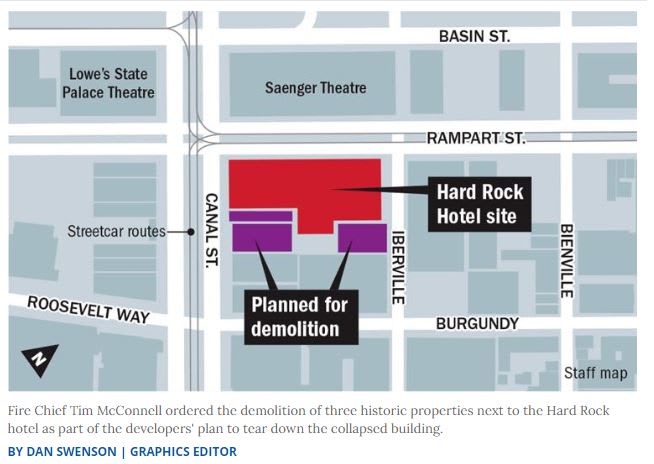

May 5, 2020; NOFD chief orders historic buildings near Hard Rock torn down, clearing way for hotel demolition: Article Link
New Orleans Fire Superintendent Tim McConnell issued a demolition order for three buildings surrounding the site of the partially collapsed Hard Rock hotel, removing the final hurdle to bringing down the hulking wreckage.
The order comes a day before the Central Business District Historic District Landmarks Commission was set to decide whether to allow the demolition of the buildings, two of which are considered historically significant structures.
The site owner and demolition contractor claim they need the space of those buildings in order to stage cranes for the dismantling. Idk if I believe them 100%, but the demo has been approved.
