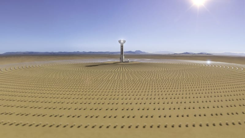

The spacing might be tied to the accuracy of the pointing mechanism sensors, which might have limitations on how close together the mirrors can be in angle space.

Insofar as the first image posted is concerned, that might have been artistic license in the animation; most of Heliogen's other materials show much tighter mirror spacings, consistent with previous solar arrays.

That makes sense. Be interesting to know how the mirror tracking system works.

Heliogen's patent shows 4 sensors outside of the target that look at the reflected sky from each mirror and tries to balance the measured sky radiance from each sensor to center the reflection of the sun to the centroid of the sensors. Because the sun itself is never imaged, it does make for a more challenging optimization problem

I suppose you could program the tracking movement of each mirror based on the known precise astronomical position of the sun over time. That approach would just need initial calibration.
How big is the target relative to the reflected beam width?
That's a blind control (conventional) approach, since you have no direct feedback whether the mirror is warped and caused the sun to be pointed off-target; Heliogen's approach uses the mirror reflection directly, although not of the sun, per se, which ostensibly improves the pointing accuracy. Heliogen's approach does not require calibration and is tolerant of post-installation misalignments of the mirror relative to the control system

Thanks for the summary, I knew they were "doing something better" with the mirror alignment, but I didn't know the details. Yours is a good enough summary that I feel like I at least understand the concept for why it's better than the ones at Ivanpah or such.
For what it's worth, it's clear that Ivanpah had some serious mirror alignment problems as they damaged one of their turbines severely once due to misalignment of mirrors. Ergo, this is a serious issue and is one of the reasons why Heliogen's technology is getting good publicity.
IRStuff,
Thanks for the details, and I agree, any programmed approach (blind control) will inevitably drift off target eventually.
With the sensor-based system, would it be possible to use only a limited number of mirrors, with surrounding neighbours working off the sensored mirror in a sort of master/slave arrangement? One sensor for each mirror seems extremely busy.
