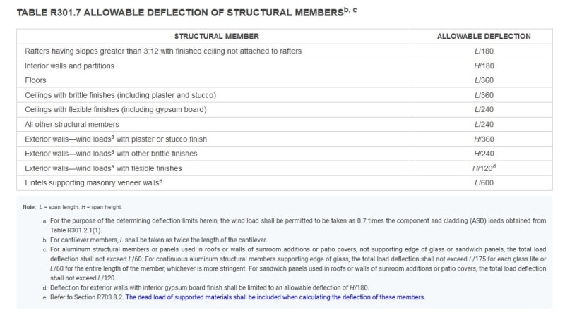

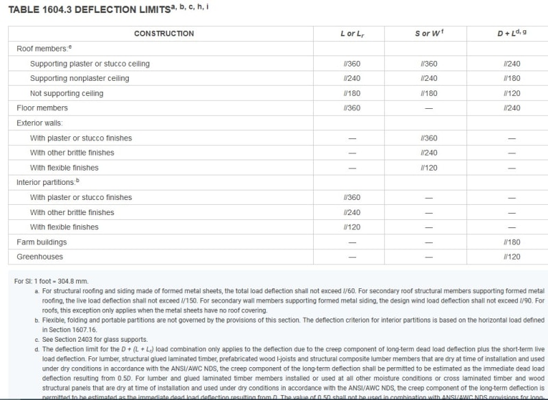

Also, if you are sheetrocking the rafters, they need to be L/240 now. So another way you are touching it.
That I think would be for the transient load alone, snow or wind, for D+L it would be L/180.

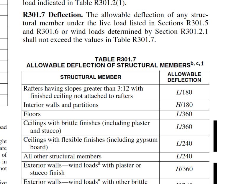

This is more likely IRC, which is more vague about what loads apply to the deflection limits. At least I got the feeling it was residential.
This is going to be quite challenging to get the roof assembly to work, in an engineering sense, if you ask me.
Ah, I guess the NC version is different.
Either way, if that sheetrock starts cracking, there is going to be some finger pointing.
I was tired, so I only posted the IBC language.
Your IRC is probably similar, the language on the situations doesn't match between IBC and IRC ("nonplaster" versus "including gypsum board" for example) and the IRC doesn't clarify by adding a load case.
Source: 2021 IRC, Table R301.7
Darth engineer can apply it however they feel (most favorable) and Obi-Wan engineer can apply it in the most restrictive sense (least favorable).
