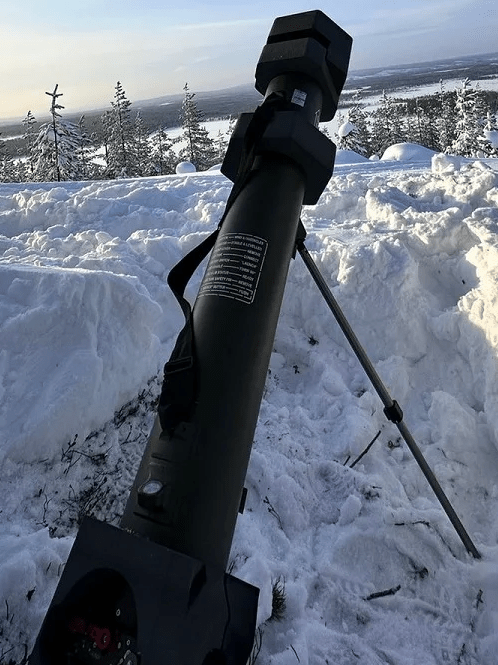

I have a different question but related to the above. Typically, what materials are these tubes made of? At least the contemporary ones? Example of a contemporary system would be Common Launch Tube (CLT)...Composites are a great choice...just wondering if other materials (other than metallic structures) are being used (perhaps newer plastics)?
pert near anything that can handle the pressure loads, after that (and a million other design decisions ... environment ? weight ? ...?) it is what is cheaper/easier for you.
If the tube is ground mounted, just use steel.
If aircraft mounted, then weight matters, so maybe composite or aluminum or titanium.
It all depends on a lot of detailed requirements- loads, environments, weight, cost, number to build, etc.
For the initial set of prototypes, we will be using Aluminum since excess weight is a consideration but not a requirement. Just part of overall literature survey, was curious to figure out what kind of material these types of launchers might be using...
is this a "mortar" with repeated firings (but the legs look pretty spindly) or more of a one time deal ?

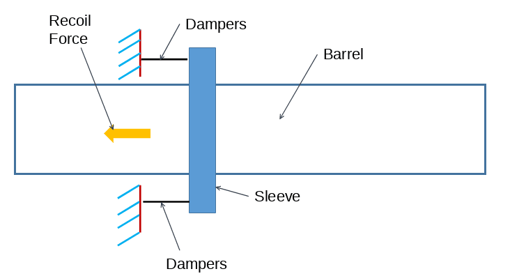

I wanted some tips on simulating recoil force on our launcher. The launch is being done by pneumatic means and considering the pressures we have, the recoil force is gonna be significant. For verification, I want to do a FEA.
The setup illustration is shown below.
Obviously, I've simplified the diagram and omitted a few mini-components. Currently, we plan to deal with the recoil force by using a combination of barrel travel & dampers. I understand the recoil is a dynamic event but I am hoping to do a static analysis for the 1st cut verification. We've calculated recoil force using simple rigid body equations. The material of the barrel & sleeve will be Steel AISI304/316. The solver I'll be using is MSC Nastran.
I am hoping to spread out the entire recoil force on to the barrel using RBE3 MPC. The dampers will be represented by CBUSH elements and one end will be fixed. Does this FEA setup makes sense or am I missing out on something that would be make the setup over simplified?
Is recoil "just" the pressure acting on the barrel behind the projectile ? I think you need a dynamic model to determine the ballistics of the projectile, and the concurrent loads on the barrel
