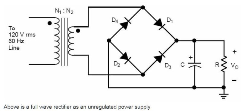

Is this a practical way of performing the test or am I spending too much money?
I'd say not. I'd do this; Keeping in mind your meters (volt and amp) will be the standard.
I'd fore shore get the Variac from ebay and I'd use a bridge rectifier (cheap as hell) and a capacitor to make the 125Vdc. A wee bit of DC ripple will make no difference in the DC test.
No reason you can't use the Variac for both tests.
Get one of these.
General-Radio-Company-Variac-Autotransformer-W20MT3-140VAC-20Amp
They're bomb proof. Mine looks like it was tripped on the top stair. Mine also has an ammeter and a volt meter on it which are nice but not necessarily needed since you can add an exterior one.
Rectumfryer
Crapacitor
Wire things well and as a matter of course put something between you and the rectifier and you and the capacitor.
Always turn the variac on at ZERO Volts and turn it up over 5 seconds.
Recognize the capacitor will store a lethal voltage indefinitely after power is removed so mount a Power Resistor across the capacitor. Note it will get pretty warm. This resistor will bring down the cap voltage, on power OFF, to a safe level in about 9 seconds while dumping 22.5 Watts steady-state. There are much sexier ways to handle this safety aspect but none warrant the time or money on this test.
You hook it all up exactly like this. The only difference is the transformer is an autotransformer that's variable. (The Variac)
Keep in mind that typical Digital Multi Meters will choke on 10A continuously through the crappy test leads. You may need to ebay a real DC ammeter with real screw terminals for the 125Vdc test.
Of course cut out the rectifier and cap for your pot tests.
Wear safety glasses.
Do not do this while talking to anyone.
It's a good idea to have someone "around". (For CPR)
And of course follow the standard rule that you literally - Keep One Hand In Your Pocket.
