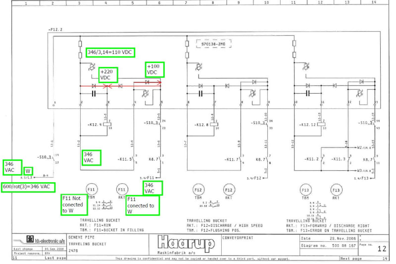

I am working on installing this new system for a company and there is some confusion on what this component is. The original manufacturer is out of business, and has been for a while. I cannot find any information on the part or anything. Its like a ghost. So, according to this print I am to wire 3 phase, 480vac to UVW. Now, they are sending a and b phase to power the primary side of a control transformer (pg8). C phase (L3 in the print) they send to terminal 1 on the unit in question (pg 12). F11, F12 and F13 are inputs associated with each sub-circuit of the device and close the associated relays corresponding to their respective outputs (k12.4, k12.8 and k12.12). These relays tied to these outputs are 110 VDC coils, so I am assuming that this component (page 12) is some sort of rectifier that takes 277vac signals and rectifies them for use within this system. Their people (who have never worked on this machine) are telling me I am to put 24vds signals to f11, f12 and f13. I don't see how that is possible with 277vdc being common between all 3 circuits inside of the component. I'm not quite sure what the blank boxes are at the top of each circuit, within the component (pg 12), or the box with the line through it diagonally (pg 12). when I TEMPORARILY jump 277v to F11, f12 and f13 those relays energize. Have any of you guys seen this circuit before, and what are the two symbols (besides the diodes and N.O. contacts in each subsystem in the component?

Typically a box with the line through it is a MOV, or metal oxide varistor. But I've never seen the short interruption in the line connecting to the MOV. Boxes with lines to them are usually solenoids, but sometimes represent the coil of a relay. It all looks a little odd to me - almost like fluid logic symbols mixed with electrical symbols.
Right, no its all electrical. I should have added the caveat that its European. Their symbols are quite different.

Those are indeed MOVs on page 12. The gap is some sort of document error. There are random lines missing elsewhere in the document.
The two 'boxes' at the top of those pg12 lines are likely dropping resistors. They may vary with supply voltage.
The K12.4, 12.8, and 12.12 are the coils for the contactors. K is common for that designation. Those coils are being driven by rectified AC with the unlabeled capacitors providing valley filling to keep the coils from chattering.

here is the entire print....I only included those three pages since that's the only part of the system that I'm having questions on....just that component on page 12. It clearly derives its common (input 1) from a 277 v source shown on page 5. Page 8 shows where 2 legs feed a 480 to 230vac transformer and page 12 is where the 3rd leg breaks off and feeds said component. All the other pages pertain to other parts of the system I'm not concerned with. I just want to make sure that f11, f12 and f13 are in fact, 277vac inputs.

Are you able to check the wiring? Can you follow the wires to the MOVs and on to confirm the blocks are resistors?

As Keith suspected, the two plain boxes at the beginning of each circuit in P12.2 (whatever that is) are IEC symbols for resistors, so likely dropping resistors to bring that 277V down to probably around 78VAC so that when rectified, it becomes 110VDC.

The drive can not be run unless the inductive sensor -B11.5 is unaffected and it must be a dark on signal, it will be high if it is unaffected and 0 when it is.
When the buket arrives for loading the induktive sensorer signal goes zero and -K11.5 falls and the inverter stops and can not be run. When the bucket is full, the sensor becomes unaffected and the signal goes high and -K11.5 pulls. (Probably some tipping cradle and with the help of Newton.)
Then F11 is also connected to phase W in the cunducor trolly so that -K12.4 can pull and the frequency converter can start again.
As I tried to describe, I think that it is the voltage difference across the relay that is 110 VDC on the upper side A1, both the positive and negative alternating voltage is rectified so that it becomes 346 / 3.14 * 2 = 220 VDC while on the lower side A2 it is just positive AC voltage it, 346 / 3.14 = 110 VDC so the potential difference across the relay becomes + 110 VDC when -K11.5 is drawn and F11 is connected to L3 = W.
3 phase 600VAC /1,73 = 346 VAC (1 phase)
As someone pointed out it is a varistor for surge protection if it is connected its probably for cutting of any spikes from the cunductor trolly brushes.
